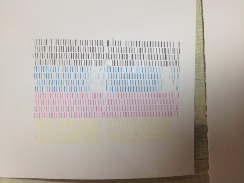

What could be causing this type of dropout? Before everybody gets on here and says change print head, I would like to try every option I can before I drop a grand on a print head....As far as background info...the machine is 10 years old and I've never replaced a damper or print head. I have changed a few cap tops , but its been a year or two. I know I've got my moneys worth outta these heads and they are probably on their last leg, but I going to hang on as long as I can. Any ideas? If I do change dampers, Is there any step by step instructions...I have worked on it myself many times (scan motor, several captops, cartridge cables, encoder stripes, etc.) so I'm capable of doing it.

If you do a nozzle test then a medium head cleaning and the next nozzle test is worse, it's probably a damper. If it gets better after a head cleaning it is probably cap tops. If it stays the same over time it could be the head or cabling, but soak them first before you give up on them.
That black head has a lot of deflections...
We always kept a dated stack of nozzle test so we could see trends. Which ones came and went and which ones were lost for every.

Have you changed out the caps and wipers and done a cleaning?
If so show us a test print now...

It looks the same...
