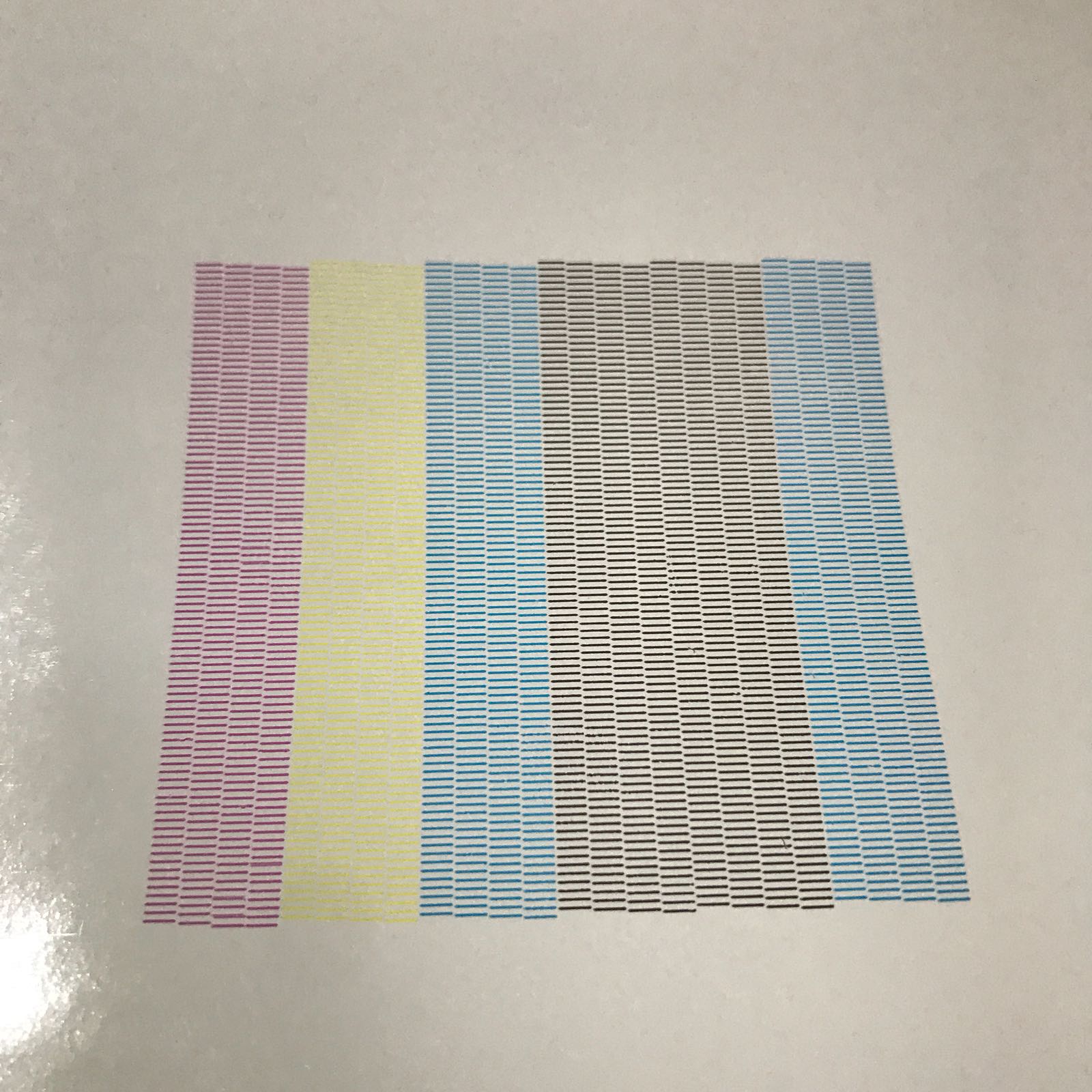

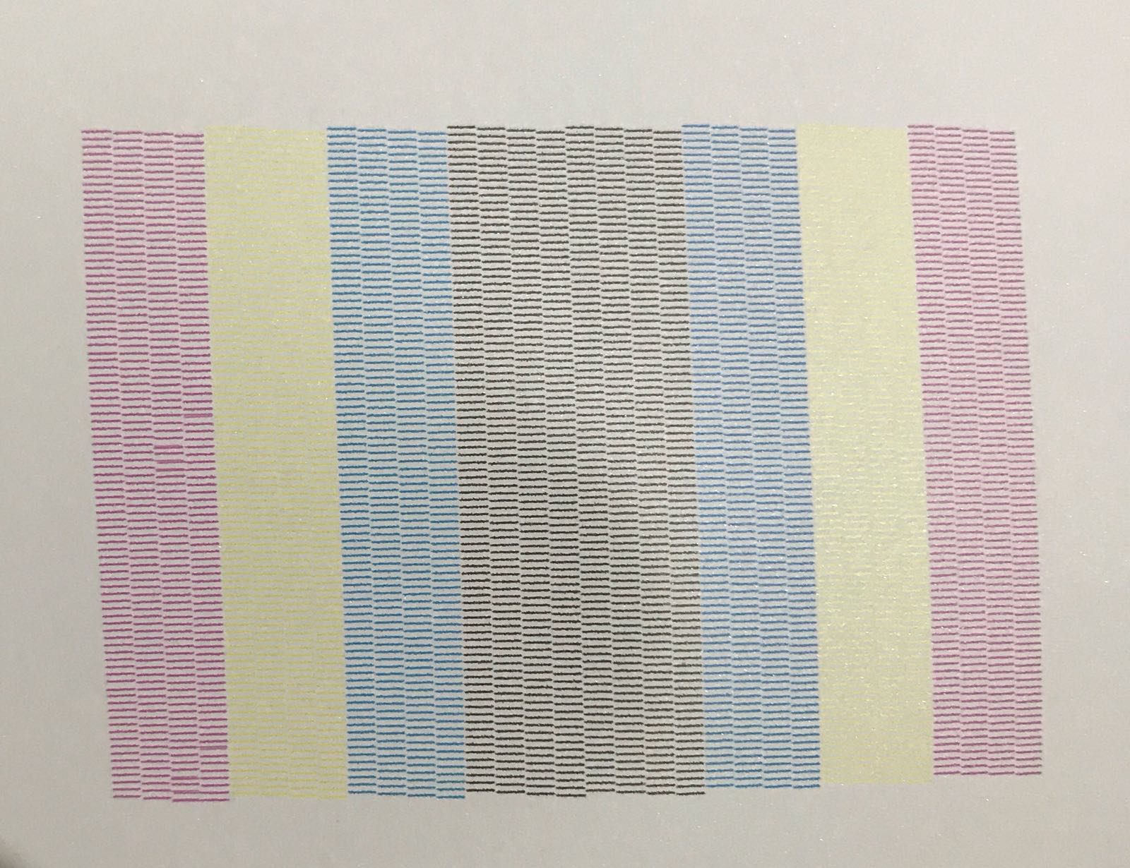

I need your expertise and experience to help me troubleshoot my machine.
I just replace an original Roland print head on 6 January 2018 by Roland authorised dealer.
All seems to be ok till today 2 August 2018.
The head is only managed to print 6 colours only.
Attempted solution:
- Normal cleaning
- Medium cleaning
- Powerful cleaning
- Manual cleaning
Doesnt seem to solve the problem.
Called the technician to come over.
He checked and said the damper all working fine, no ink clogged, cable is working, no nothing. So he is also not sure whats the problem.
Can anyone help me. Maybe there is other thing that the technician didnt see.
Attached the photo of the test print before the incident and after the incident.
Hope to hear from you guys very soon.
Thank you in advance

The tests look pretty clean... I'd be thinking some sort of electrical issue rather than head issues. Maybe try re-seat the ribbon cables.

So today Roland tech replace the printhead and the Connector A : 1000006702 CABLE-CARD,29P1 256L BB HIGH-V
Here is the outcome
Yellow color still not coming out.
Other attempted solution:
- Swapping the cable between 1,2 and 4
But still doesnt solve the issue.
So tomorrow he is going to replace cable no. 3 Connector C : 1000006703 CABLE-CARD,29P1 276L BBR HIGH-V.
So if it still doesnt work, what could be other possibilities?
Really need your help, lots of pending jobs :(
