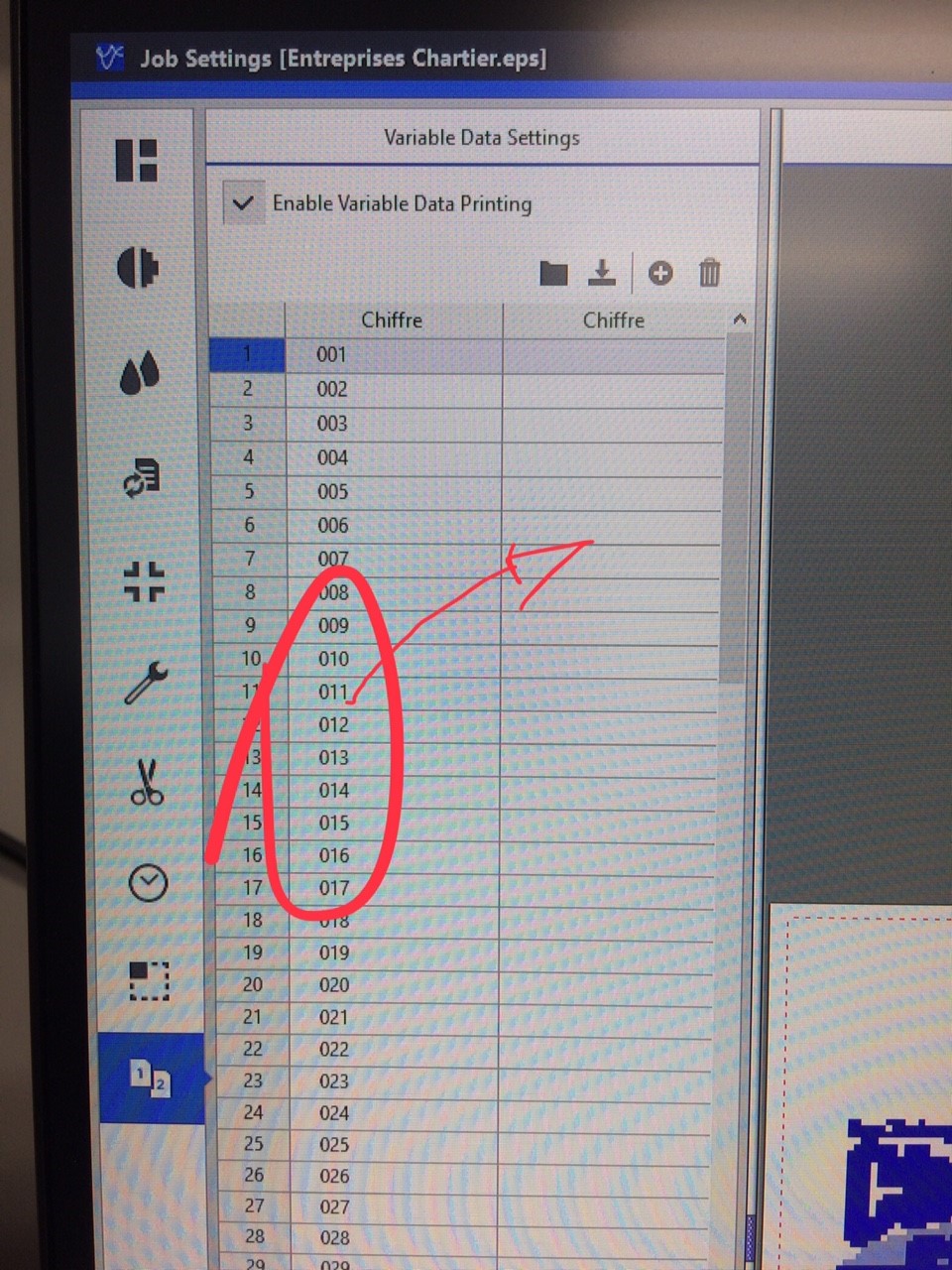

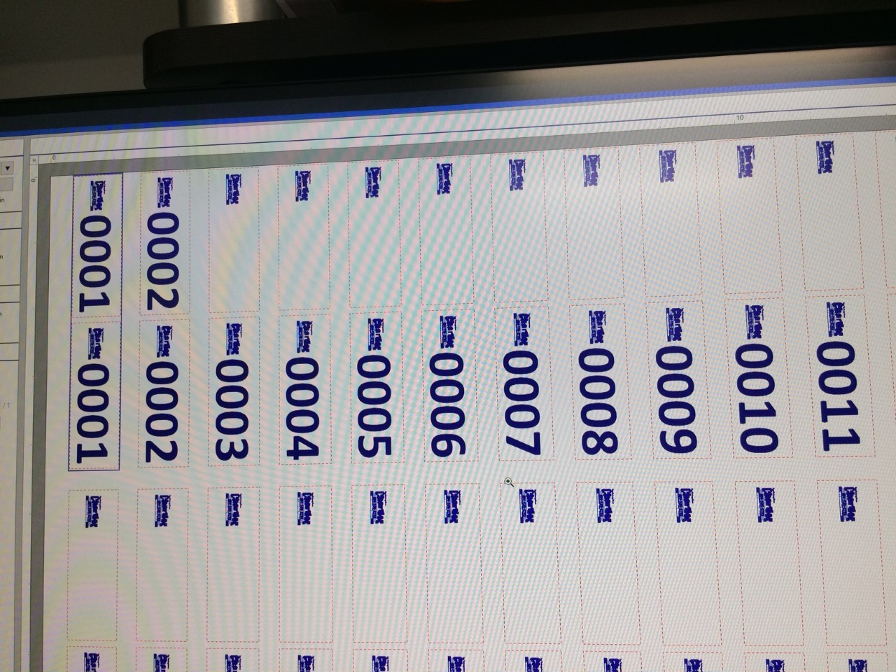

I'm used to print batch of decals for a printshop that are 0001 to 1300 but this order requires to have 2 identical decals side-by-side in roll form. I created the file in Ai with the appropriate box for the number, duplicated it and saved as EPS. When I open it in VW, I see the 2 decals side-by-side with box for the number but only one of the two as the number... but I see it has created a 2nd row of cells in the settings box so what I'm trying to figure is How Do I Copy The Left Row Cells into the Right Row??? If I type them manually, it works but no way I'm gonna type all the 1000 numbers one-by-one. Clicking on the right row tab and trying to open/import the same Excel file again doesn't works... it adds numbers at the end of the left row numbers...
If anyone ever attempted to do that and made it works, please lemme know before I turn down this job... I'm sure there's a way.

Soo what if you make them different names? Chiffre1 and Chiffre2.
Then have two columns with the names in the sheet and try to import?
Patentagosse
whatever I'm trying to do, it adds the numbers at the end of the 1st row instead of into the 2nd... frustrating.
I also have create 2 different VDS boxes with different names embedded into Ai file so when VW read it, it sees the 2 different data boxes but still can't reopen / import / transfer / copy-paste the datas of the 1st cell's row
