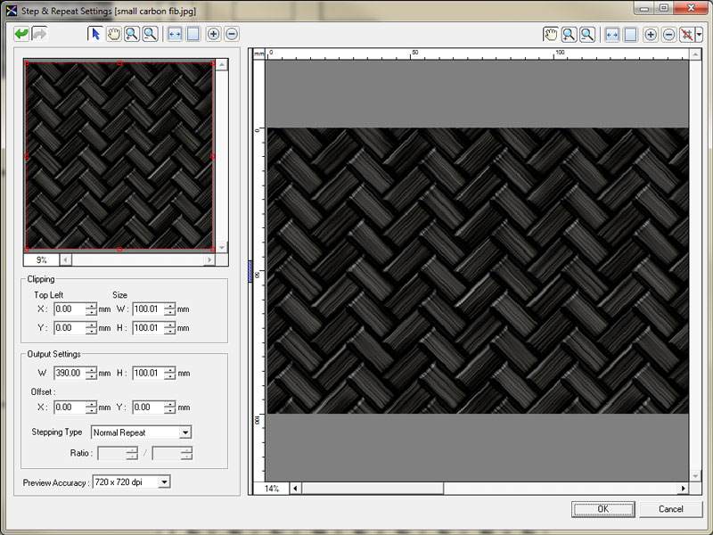

I'm playing with it right now actually.
It lets you see a preview of the appearance, however to my disappointment, does not allow you to play with scaling at all.
The feature simply lets you clip the tile as required (I can't see why you would clip a seamless tile though), and also lets you define the output size.
Eg, if your tile is 100mm x 100, and you don't clip it, and you spec an output size of 1000x1000mm, you'll get a 10x10 up.
You also have the option to 'stagger' the tiles, either horizontally or vertically, specifying different ratios. Again, not something I would use unless the tile is a solid colour. It would be good for say a badge logo on a solid background...

Like I said, nothing revolutionary, just another way.
Previously, if you wanted to do that in VW (which I never did, and probably still won't even with this new function), you would have to 'clip' the file then scale it to the required size. Reason being, that you cannot scale with unlocked proportions within VW.
The biggest use I see for this new feature is only for seamless tiling. It's really a pity they don't let you scale it though. Maybe in the next update.
