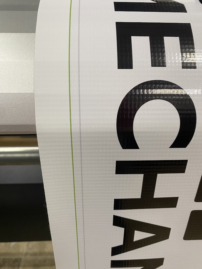

I have a VS-640 running Versaworks 4.8 and I had to reinstall recently and lost all of my settings. I know there was some setting I changed to prevent white from trying to print but I can't for the life of me remember what it was. Basically I want to be able to send a file with a white background and have 0 color output anywhere there is white. Right now it is printing like a very light hazy blue color (photo attached) anywhere there is white in my file.

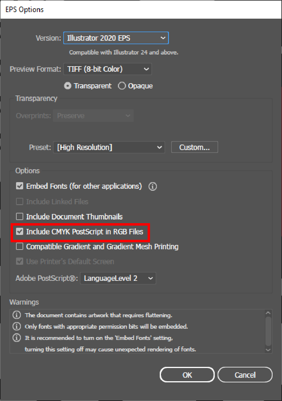

UPDATE - Figured out the issue - Definitely an illustrator export issue. Just opened original .ai file and exported from another computer, no white printing. Opened export settings from "white printing computer" and the only difference was the attached checkbox wasn't checked. Fixed that and now no white printing.
