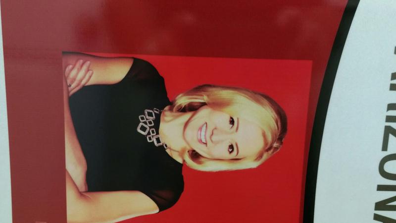

One other question with an issue I've been having. When there is a transparency, the print 'shows it'. Attached is an example photo of a file. The photo is transparent where the square is, but versaworks is printing it lighter. I can't figure out how to fix it.
oksigns
Hard to say exactly without knowing how the file was built. I'd say it is a mix of RGB and CMYK elements that when RIP'd, caused this. Double check that photo is masked properly and is truly 100% "empty".
OK, cool, thanks!
There is a color management Preset in Versaworks built specifically for this issue, called Full Page Conversion Mode. It often times resolves this (though not always).
It is located in the Job Settings dialog, on the Quality Tab, in the area labeled Color Management, in the Preset Listbox.
In cases where the preceding does not work (using certain transparency effects), the next step would be to rasterize the file at an acceptable resolution. This fall-back approach consistently resolves the issue.
