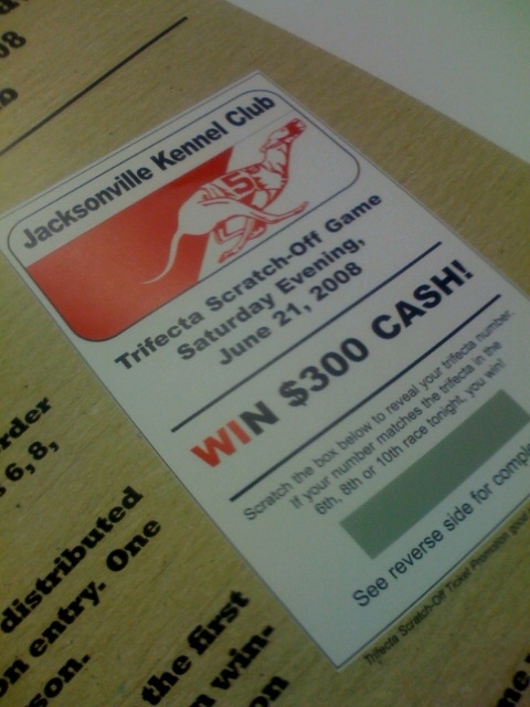

I was printing a poster today when I noticed the color changed on some text. My customer sent me a PDF file that she created with Quark and I sent it to the printer (XC-540) with VersaWorks and when it prints part of the letters change from red to black. I had the same thing happen with another of her posters last week.
Is this something others have experienced?
Is this an issue with Quark PDF files or VersaWorks?

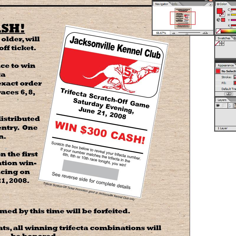

I opened the PDF file in illustrator to make sure that the text was all red and sure enough it is. I attached a screen shot of the artwork and a photo of the printed poster. I print EPS files 95% of the time with zero problems. I’ve printed PDF files in the past with no issue as well some of which were created using Quark. I resaved the PDF file in illustrator and still did the same thing. Tried to save it as an EPS file but it was 400+ mb and when I went to open it in VW it said the file was corrupt.
