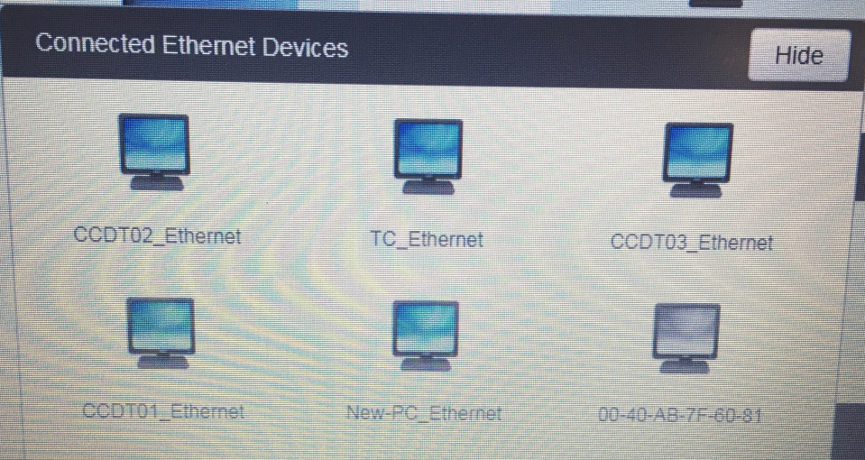

So our broad band was upgraded today and Versaworks is upset. It's ripping but not printing. I have changed the IP address to suit the new router. VW says printer is connected..can see ink levels, firmware etc...but after ripping the print status just hangs at 0% for around 20 seconds, then disappears. I have also tried printing the VW's test print file..same thing happens.
I have switched everything off & on, initialised application but it's still the same. I rang my Roland guy but he seemed quite perplexed and suggests it's a networking issue. Logged into the new router and the printer shows up as being connected but it is greyed out(see bottom right icon in pic). Not sure if that means anything.

It's fixed now anyway. Was an IP address issue.
