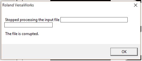

Hi all,
Just wondering if anyone else has come across this error with Versaworks and what they did to remedy it. It seems to be happening more and more frequently. My usual fix is to simply restart Versaworks and/or my computer, trying to clear the cache. After restarting, I am usually able to input the exact same file that was causing the error successfully. Today, I did just that and two files later, it came back.
I am running Versaworks 5.5 on a Windows 10 machine.
Thanks!

The file type is PDF or EPS due to adding Contour Cut Lines, so flattening/rasterizing it really isn't an option.
I know that Verwaworks in a bit finnicky about a lot of transparencies and effects, so I don't add them often or at all without flattening. In this case, it's a flattened bitmap with a circle overlay for a contour cut line. Pretty basic, so I'm not sure why Versaworks keeps kicking it back.

I've noticed this glitch happening more frequently over the past few months. It's odd that simply rebooting VW resolves it. This isn't an issue of an effect or file type color setting etc.., I can simply reboot VW and the exact same offending file loads, fairly empty due and all.
