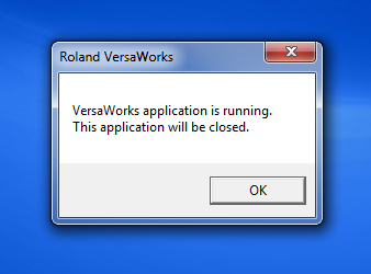

I have been having all kinds of problems a week ago lost a hard drive, had to rebuild my computer and get VesaWorks reinstalled and working, then I had issues with teh IP address with the printer (SP-540V), got it connected and printing.
I have been sending test prints to trying to eliminate some banding issues, then all of the sudden got an error message saying VW stopped working, it had ripped a job to 100% then hung up.
I closed VW and every time I try to launch it I get this message below:
VersaWorks application is running.
This application will be closed.
When I reboot my computer, VW will launch, but when I try to print, it hangs up.
  • VersaWorks application is running - This application will be closed 1-18-16.jpg
Good news, the VW issue was because my external WD DUO RAID 1 hard drive went to sleep (i think), because when I rebooted my computer, the hard drive was initiated and NOW VW is working, go figure.
