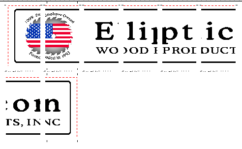

Hi guys. Have a large 8' x 32' sign I need to do. I planned on using the Versaworks tiling feature, but it's not playing nicely. Without the tiling, it will cut fine, but once I ask it to tile the art it will all of the lines. Without the the tiling it will cut fine. Attached is what I'm getting, scaled down for the screen shot. It doesn't completely cut out each panel. It wont cut ANY of the bottoms of the panels.

looks like the tile has cut the bottom of the design and your contour cut off, which is why I think you dont see red lines at bottom of design...might want to check you dont have an extra tiny little tile at bottom...
and its been a while since I tiled a cut with versa but Im pretty sure it doesnt close the cuts between tiles automatically...I tile everything with cut lines by hand in Corel and generally only tile large trailer prints with no contours in versa
