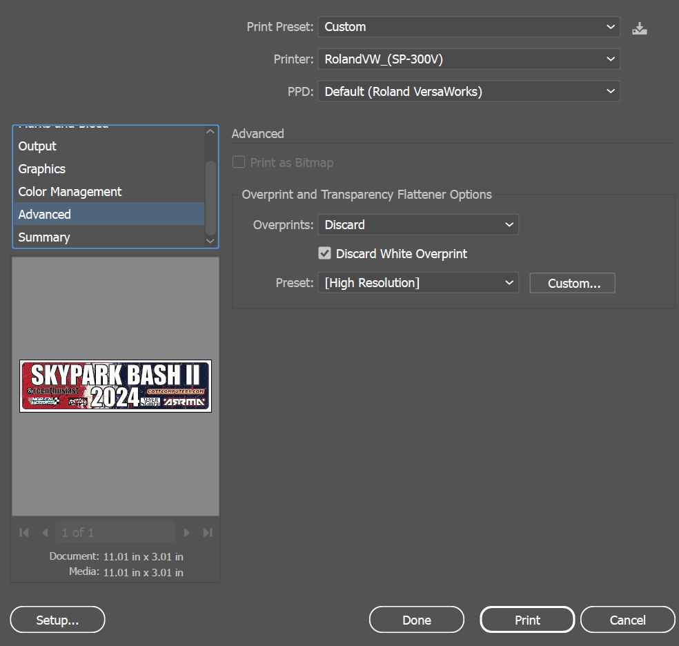

I under stand that this is a necrotic thread, but I had to... I feel like this is something that you run into if you have an older printer and a newer system.
I am currently running Versaworks 5.5.1 on an sp-300 with windows 11 and the newest version of illustrator (2024).
The fix it stupid simple, you just need to file > print or ctrl+p. Then on the left select advanced, finely [High Resolution]
This fixes it.
