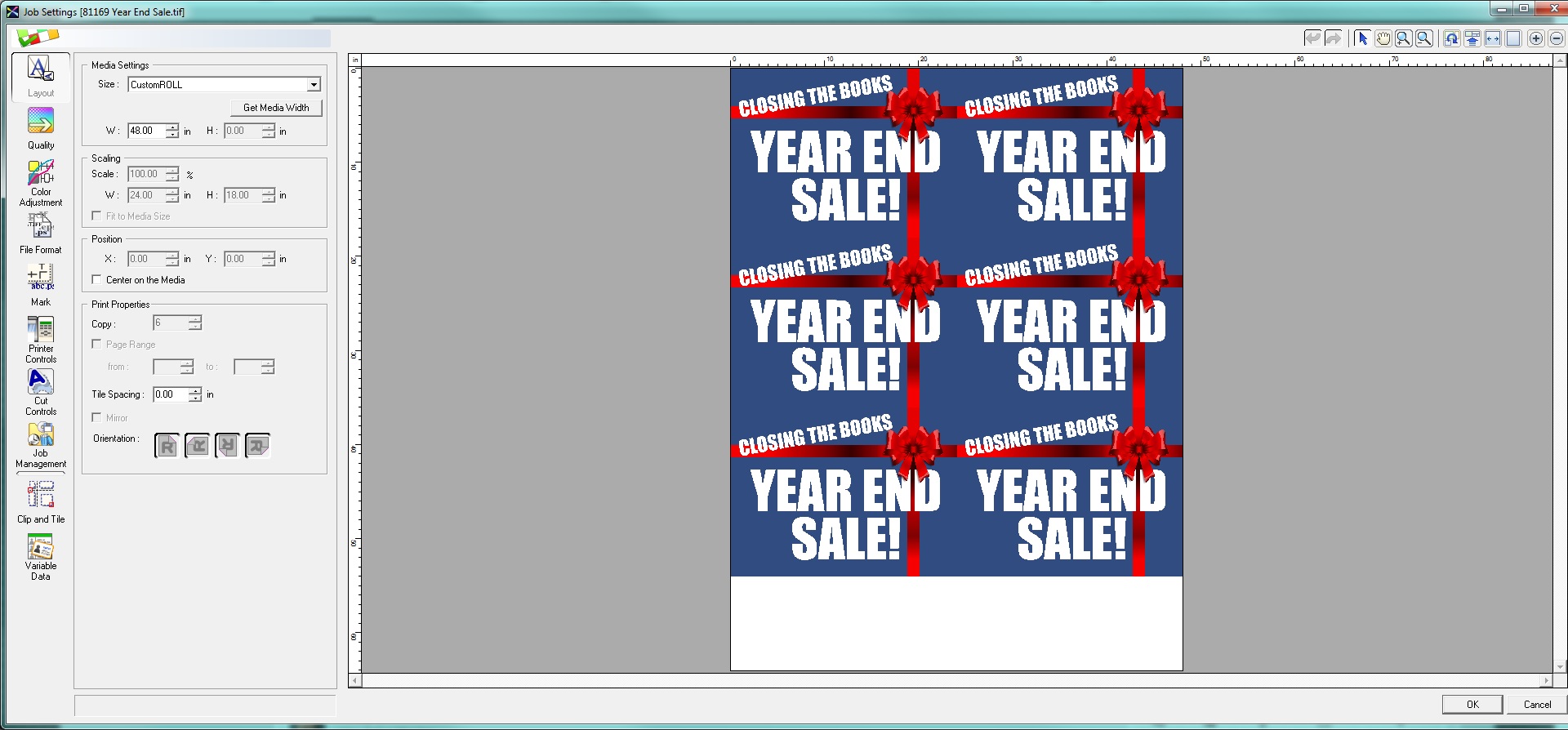

Here's a screenshot with my settings.

Maybe it's a Corel thing? Like Jay, I use same version of VW as well. Use Illustrator generated PDFs and setting the tile spacing to 0 it always butts them together. That being said it butts the edges of the art board together when using PDFs, not the edges of the image.

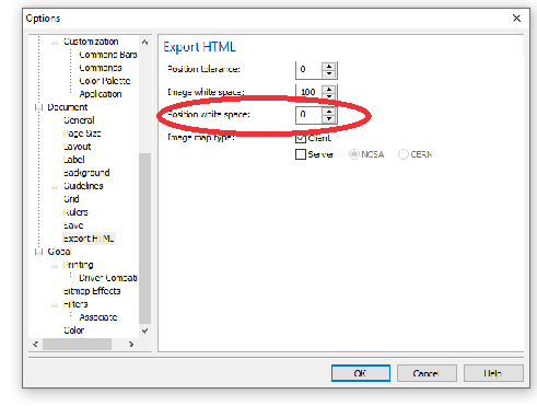

I'm glad you posted, I have meant to respond what the issue was;
I had to change settings in Corel, for some reason the "position white space"
defaults to 4, I changed it to 0
