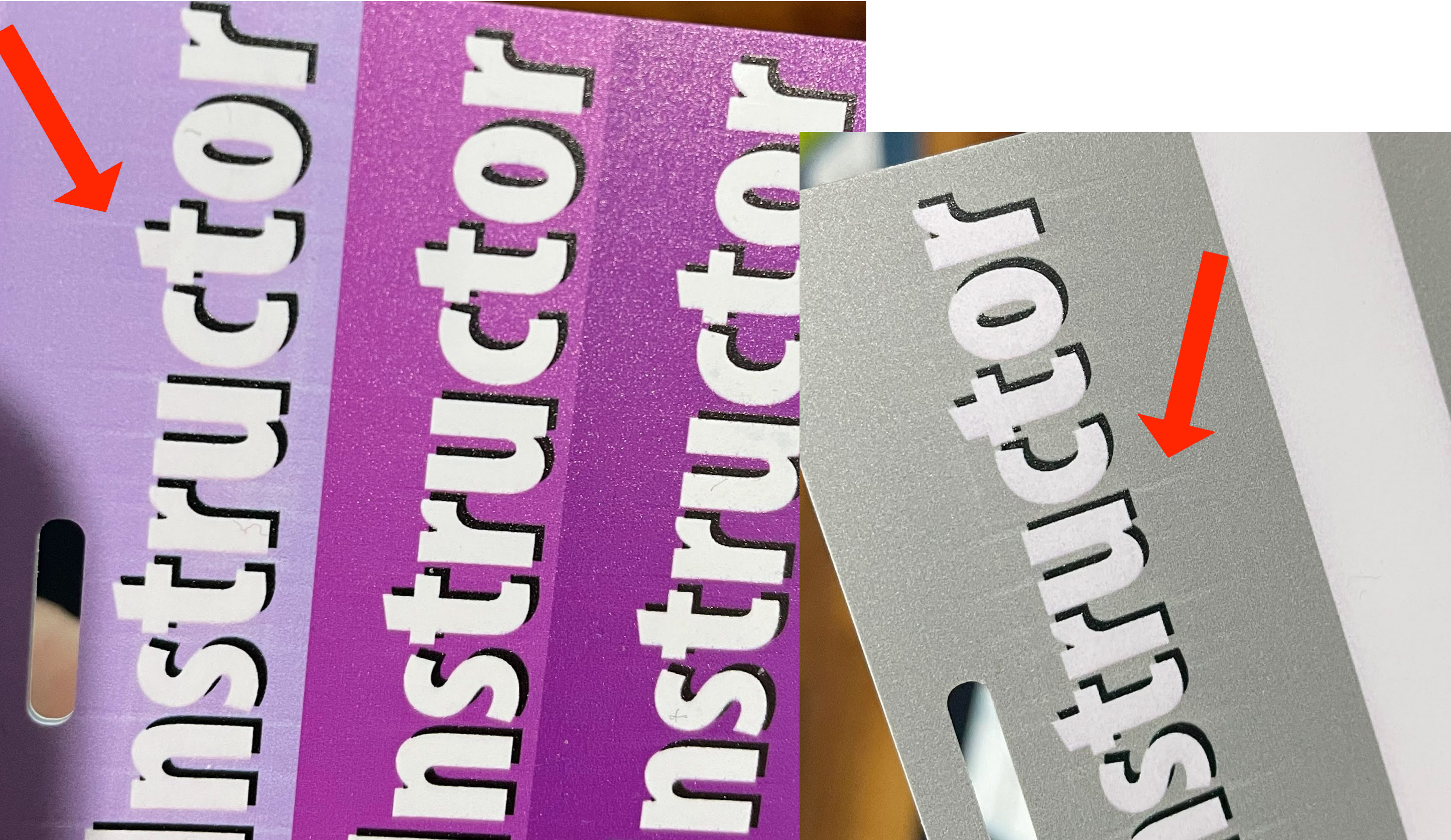

I have been having issues with lighter colors on Roland UV LEF2-300 (VersaWorks Latest Version)
These small white lines are appearing right next to the text, it looks like the lines are runny, I'm not even sure how to describe it.

IggyM
Looks like a form of ink starvation, assuming the black line and light area are running in line with the printhead direction. That's all I can help with, not sure how to fix it.
This only happens with lighter colors. The dampers are primed and full.
We have two Jigs. One is aligned with these error lines and the other one is at 90 degrees.
On both jigs the errors are identical, that's why my best guess is something to do with the RIP or files.

IggyM
Hopefully, this image will explain it better. When we print, depending on the jig we use, the rotation of the text might be different.
But the direction of the defects is always the same (red lines on the image)
I did a few tests and it looks like it has to do something with the hard shadow.
When I remove the shadow behind the text, there is no issue.
I managed to get it down to about 65% black shadow before the defects started appearing again.
