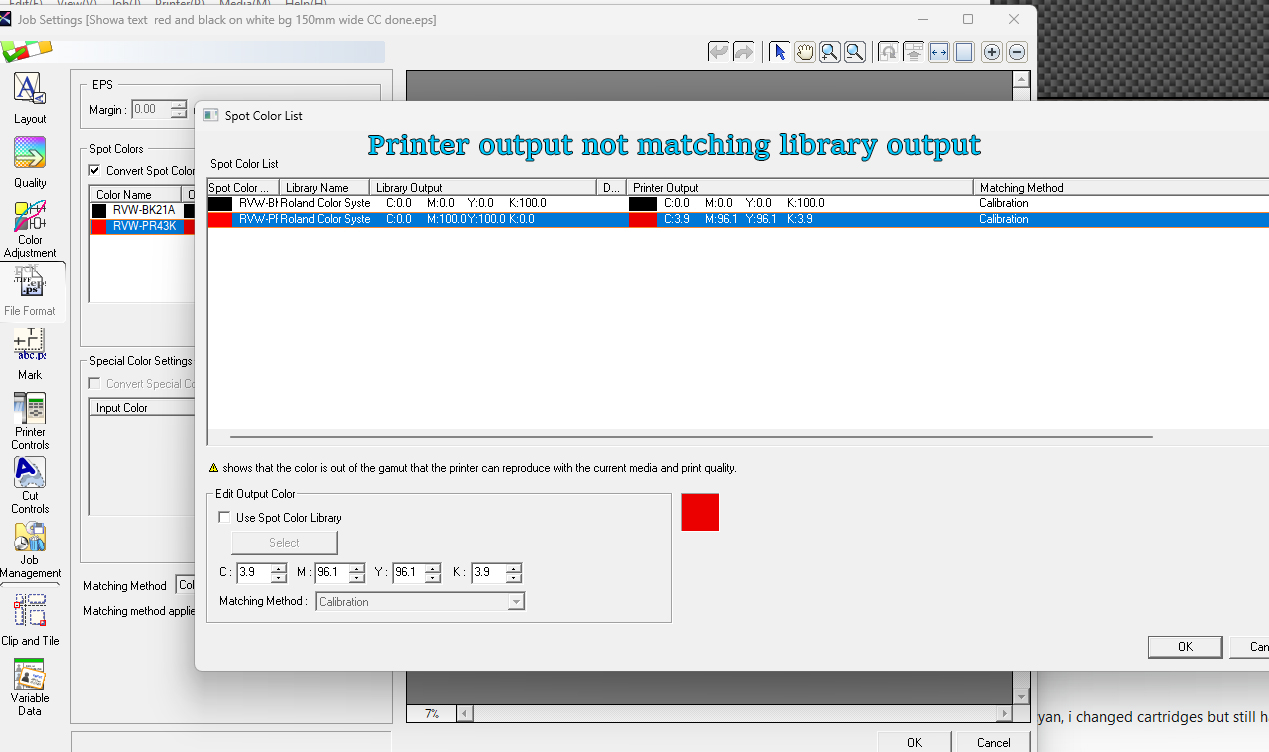

I was/am having problems trying to print pure red spot colour C:0 M:100 Y:100 K:0 on white and media type clear vinyl, versaworks changes the output to C3.9 M96.1 Y96.1 K3.9 even tho i had selected the spot colour PR43K.
This is now the weird part i went into my old pc,loaded up the files,selected convert spot colour and it was correct!! , great , so i thought i`d run a test from that computer but as soon as i plugged the network cable in it changed the settings again to C3.9 M96.1 Y96.1 K3.9
Why? , the printer must be telling versaworks to do this ?

With media: generic vinyl 1 it is ok and as it should be but i need it to work on clear film so i can print white too.
