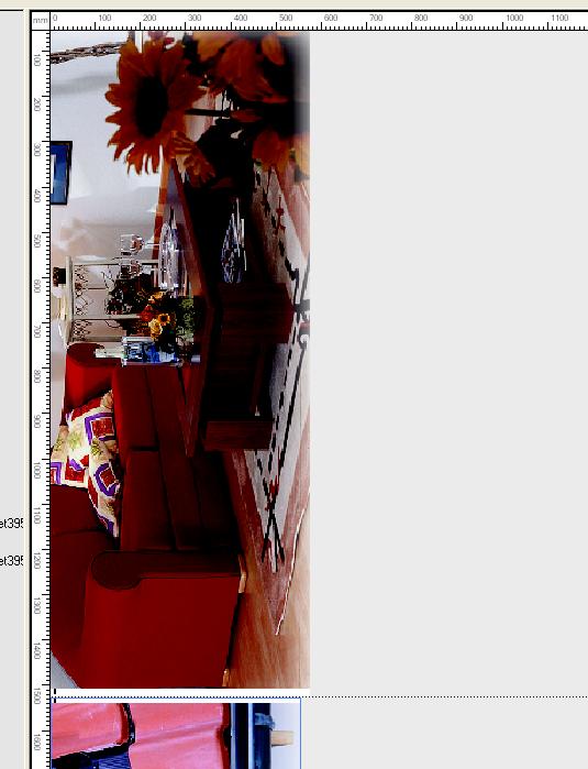

I need to urgently tile a print job and I don't want to wast a large amount of material.
Can anyone tell me how to do this. I have attached the image from within Versaworks.
Basically there are 2 part tiles from 2 images in the queue, all I want to do is print these 2 part images side by side rather than one after the other. I have the media to print side by side but I cannot find a way in VersaWorks to do it. I have tried Signlab and have been told by a user here in Ireland that it cannot be done in Signlab.
Sabre
In your job settings you can go to Clip & Tile at the bottom of the window and turn on the "Number of tiles" selection. Increase it to 2 (assuming your graphic will fit) Set your overlap if desired, and that should fix you up.
