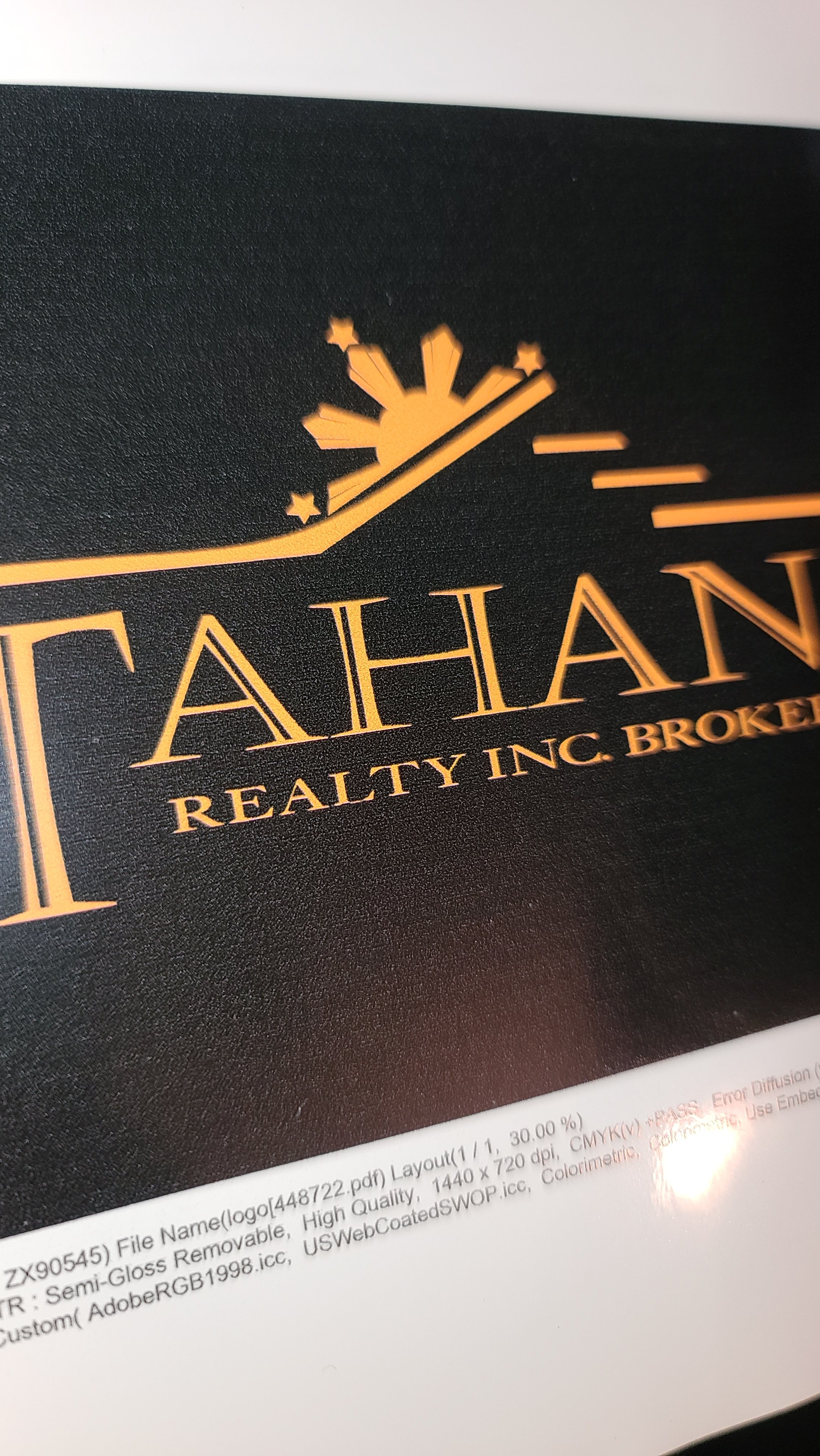

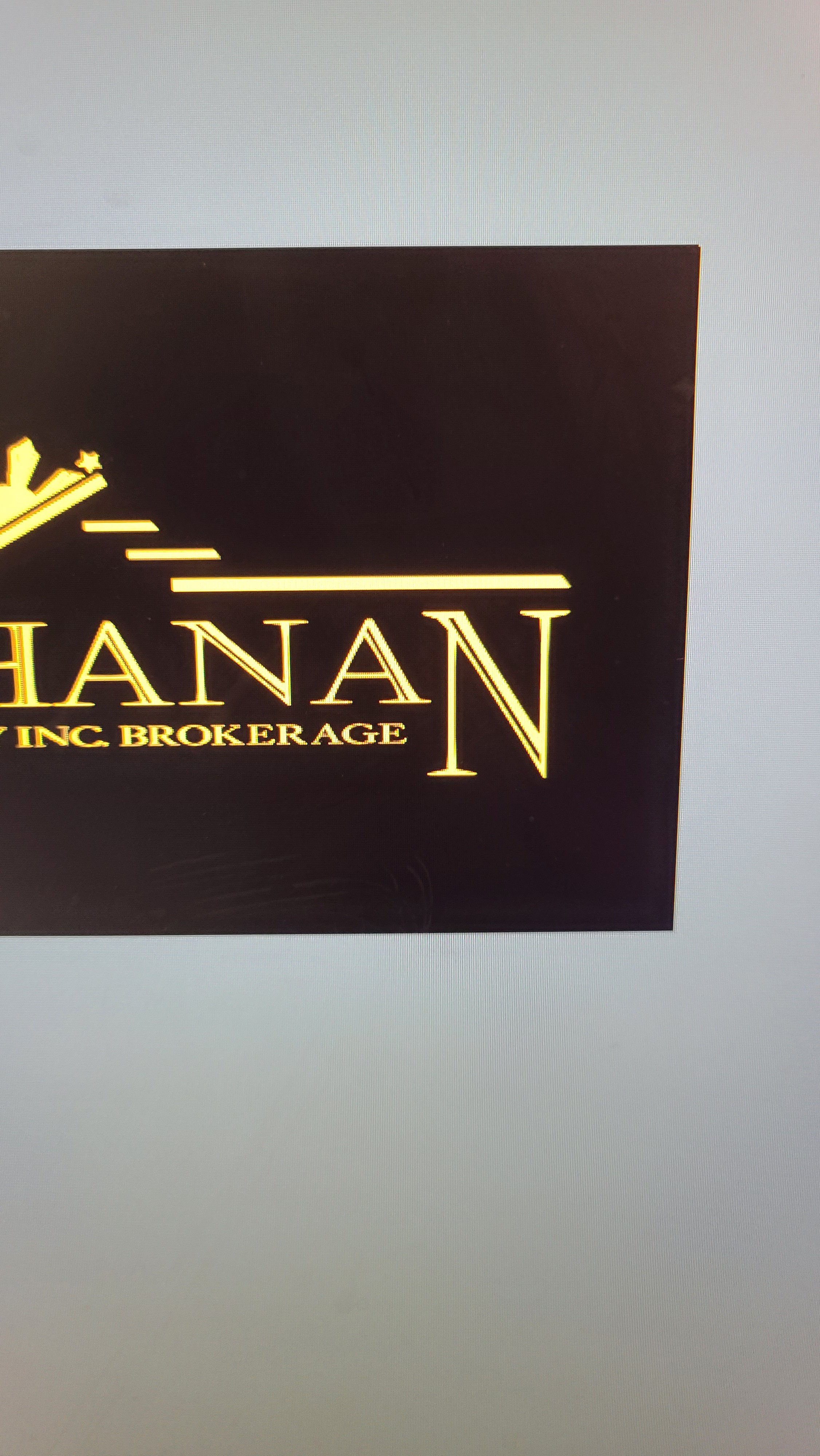

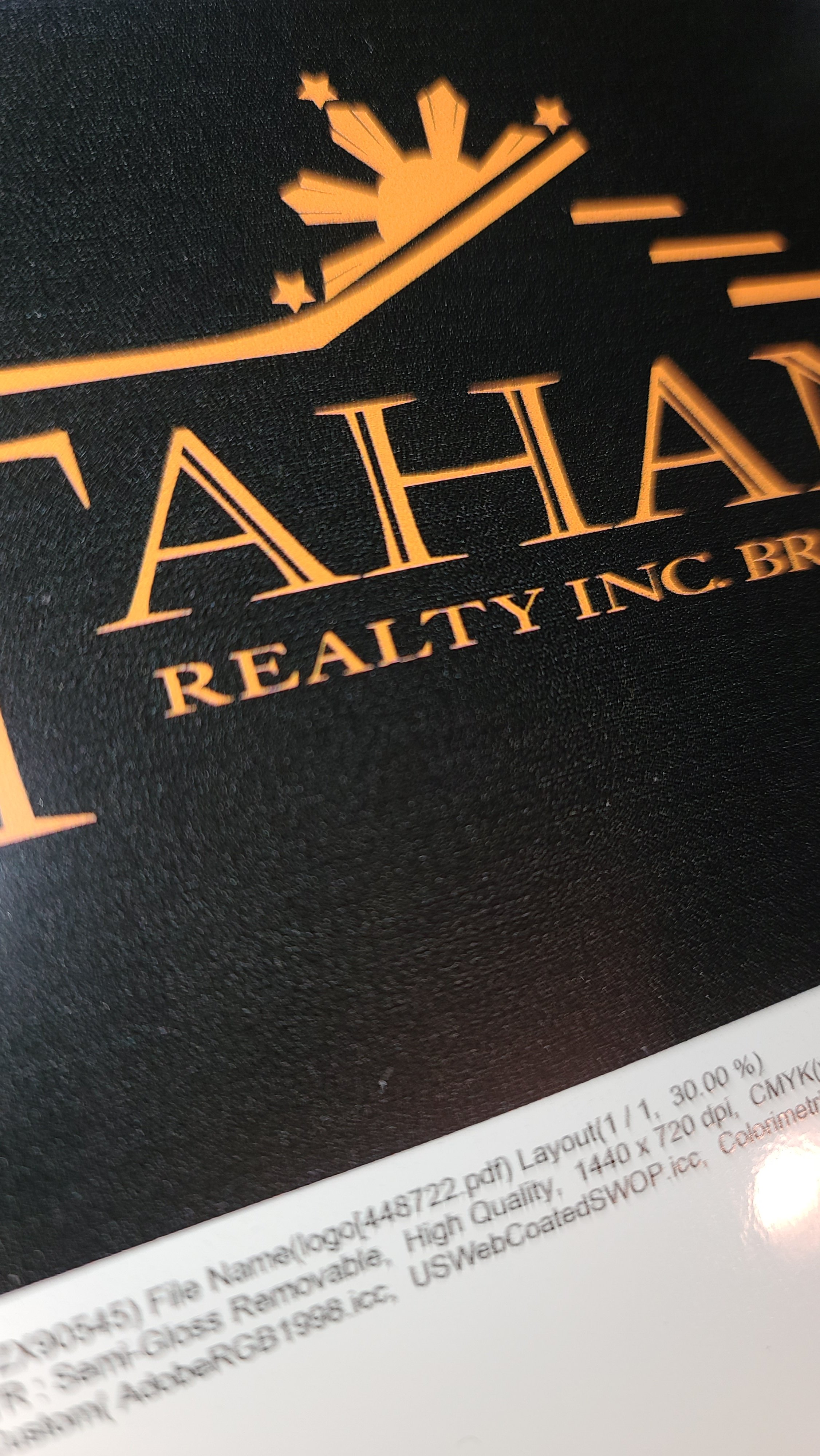

maybe upload a picture of what is getting printed out and a pic of whats in the file?
2 photos of the grainy prints on 2 different settings and a picture of the screen in illistrator as it will not upload the screenshot..

Have you tried different materials, profiles etc. You're just going to have to play around with materials and profiles until it looks good. I have a VS300 (I think one generation ahead of your printer ) and it is more grainy compared to my new SG2 where all colors look like colored vinyl with 0 grain.

I would also make sure your head alignment is perfect too, but like previously mentioned, you'll need to play around with profiles. Also have you tried going very slow, as I find on my SP-300V's, sometimes I need to go very slow to get the nice clean prints.
weyandsign
Media Type: Generic Vinyl 1, Print Quality: Standard, Halftone: Error Diffusion, Preset: Max Density U.S.
These are the one and only settings I have to use in Versaworks to not get the grainy results you are getting.
