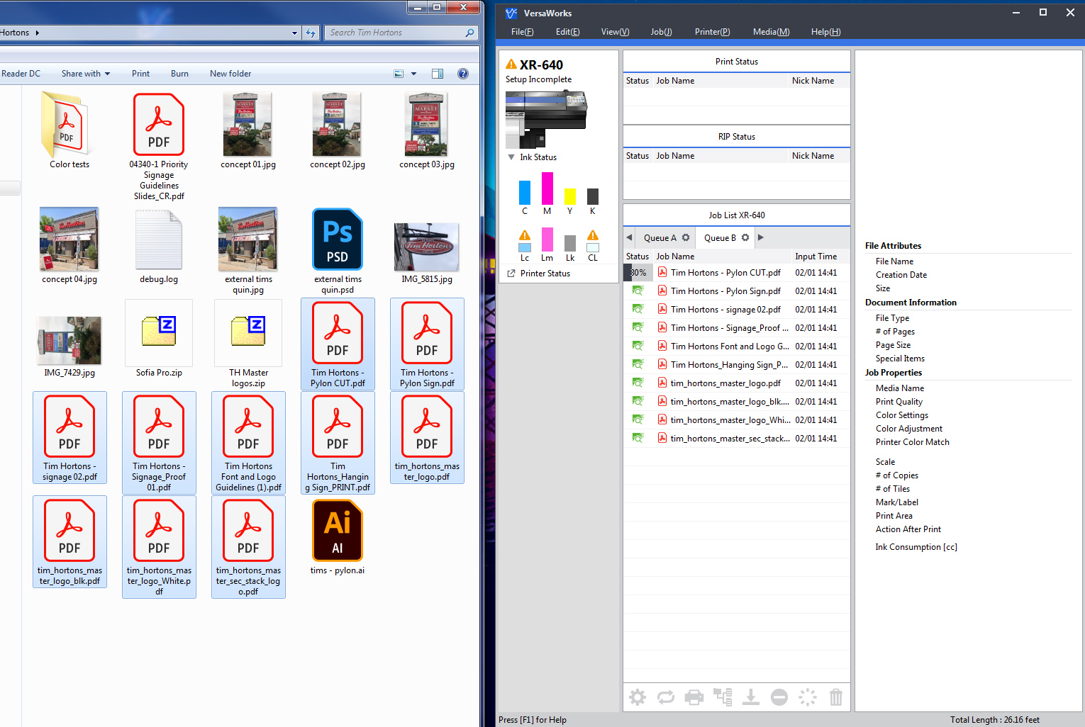

Are you not able to drag and drop them in? I always do with VW6. Straight from folder to the window
Pewter0000
Graphic Design | Production
Found a very Canadian example for you - I just shift-click the files I want and haul them over.

That's …something I am not able to do. Hmmmm... I can't drag and drop any files. Very confusing.
Can you drag and drop other files elsewhere? I'm wondering if this is a file explorer problem rather than Versa's, as I've never had issues dragging/dropping in VW6

It's only VW6. But I did find where the hot folder is located so I figured out a work around. I dropped a shortcut on my desktop for Queue A hot folder and now I can drag and drop to that, which populates Queue A. But dragging and dropping directly to VW6 has never worked for me.
