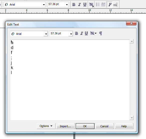

Replicator
This is the only way I know of . . .
Get to that screen by hitting the button with the AB|
