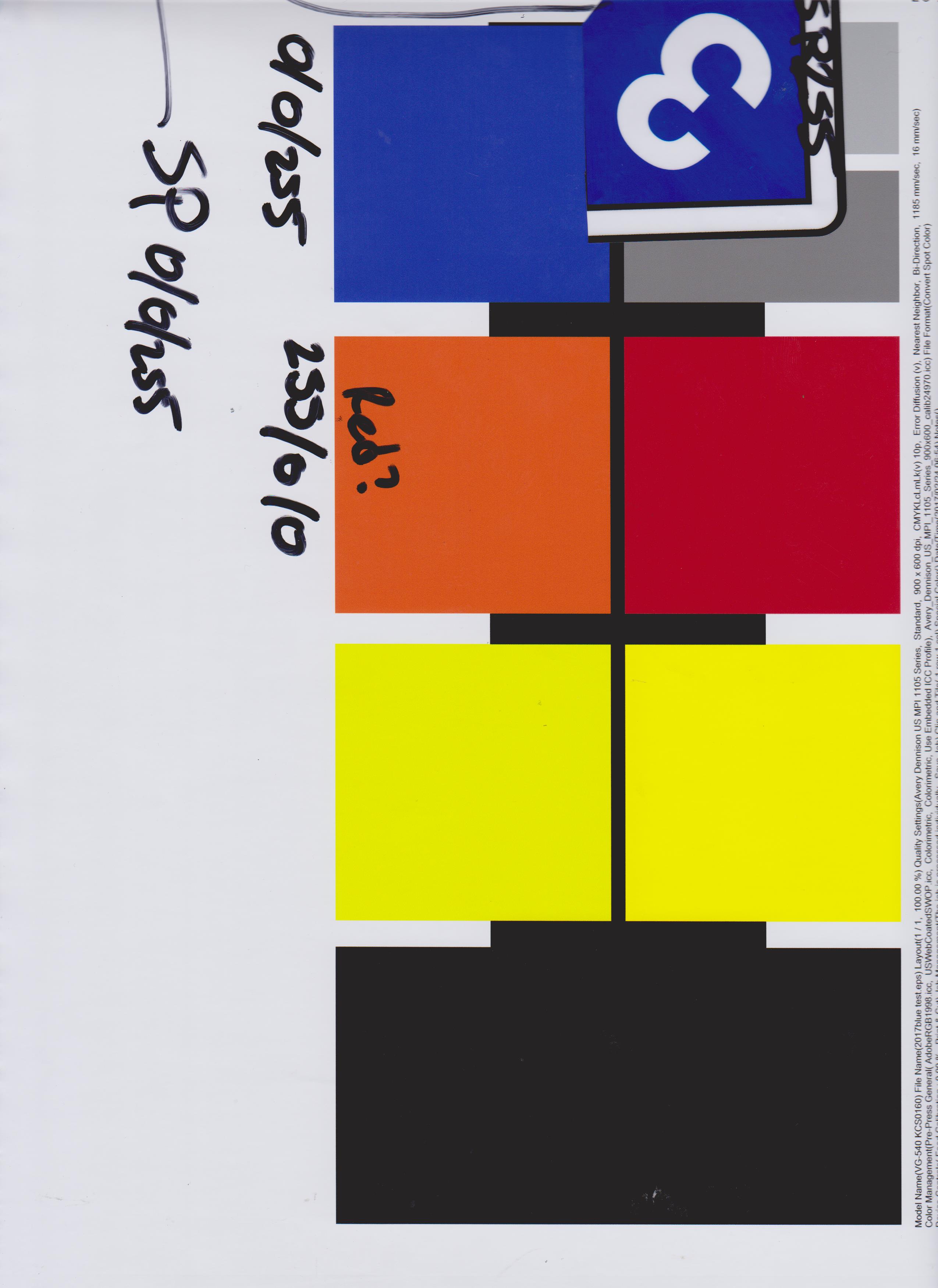

Have a new VG-540 CMYKcmk. Other than RVW colors(and these aren't the greatest either), everything seems to come out dull and not vibrant at all. I'm coming from an old sp540v and the colors are not even close to what I had been getting and other than the speed it's been pretty frustrating.
I'm saving as an eps, from multiple programs with the same results.
I have tried every canned profile along with every rendering intent possible with the same results.
I don't have a spectrometer yet, so I cant build any profiles.
Thank you in advance.

We made the same transition last october. When we first got the VG, I was blown away by the speed and quality. Now, only 4-5 months later, it is constantly going down. The cut calibration is awful, and I can't keep the print quality consistent. Now I have a print head completely dropped out and waiting for replacement only 4 months in. I put alot of miles on the SP and never had this much trouble. Also ran a VS-540i for years with no issues. I assume your using Versaworks Dual as it comes with the VG, and I have found that it processes colors in .pdf better than it does for .eps. Try sending as a .pdf to see if it helps at all. Good Luck.

Based on your description, it seems related to the media type (profile) selected. For comparison testing, try Generic Vinyl (standard) mode to see if that improves the quality (not washed out).

I can't say from color vibrancy though, out of the box the VG has been a bit brighter and bolder than our XC 540 was especially the greens. The PDF trick was also recommended to us by the installation tech, but our EPS output has been great so we haven't used it. We're running it in dual CMYK mode, although it's my understanding that the ink setups don't affect gamut just gradient smoothness so I wouldn't think that would have a dulling effect like you're describing.
Is there a checkbox somewhere that's overriding your selections? The output should change noticably between say Pre-Press US and MAX Impact. Also, the ink system is different in this machine from you're old machine so you may need too choose new colors if you don't have the ability to profile to match the old ones. There's probably not gonna be a setting that just outputs the same or similar colors.

The firmware update also fixed a lot of my cutting issues. I did not know about the crop filter. So sick of the cannot find cropmark error, so that is a must do.
I understand that it is a new ink type and was expecting some issues, but reworking almost every file has been a lengthy, frustrating process to say the least.
I don't know what could be overriding it, but there is very little color shift between outputs. It's there but not very noticeable. I know I need to just start making my own profiles, but I haven't decided on what spectrophotometer to get
