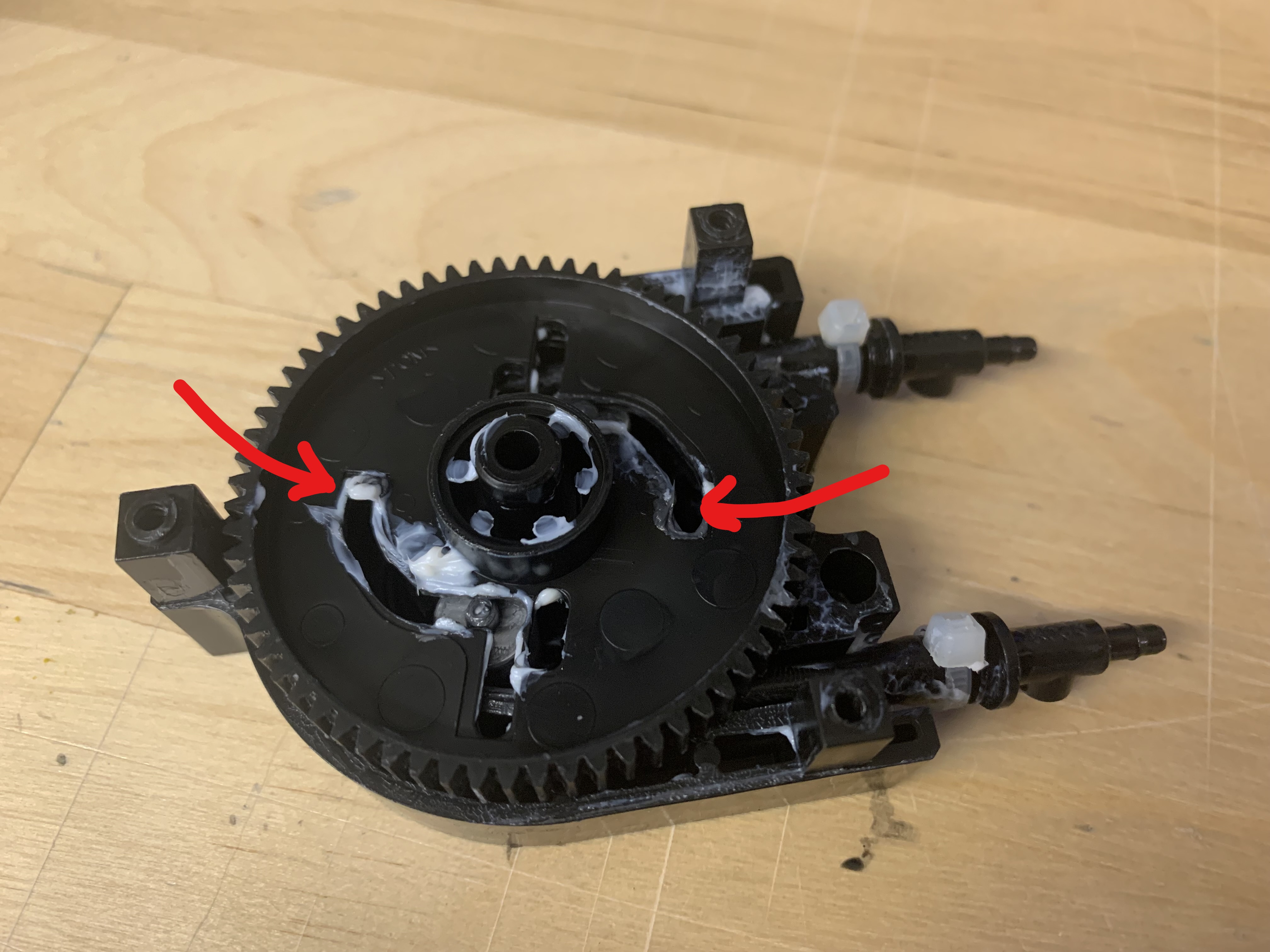

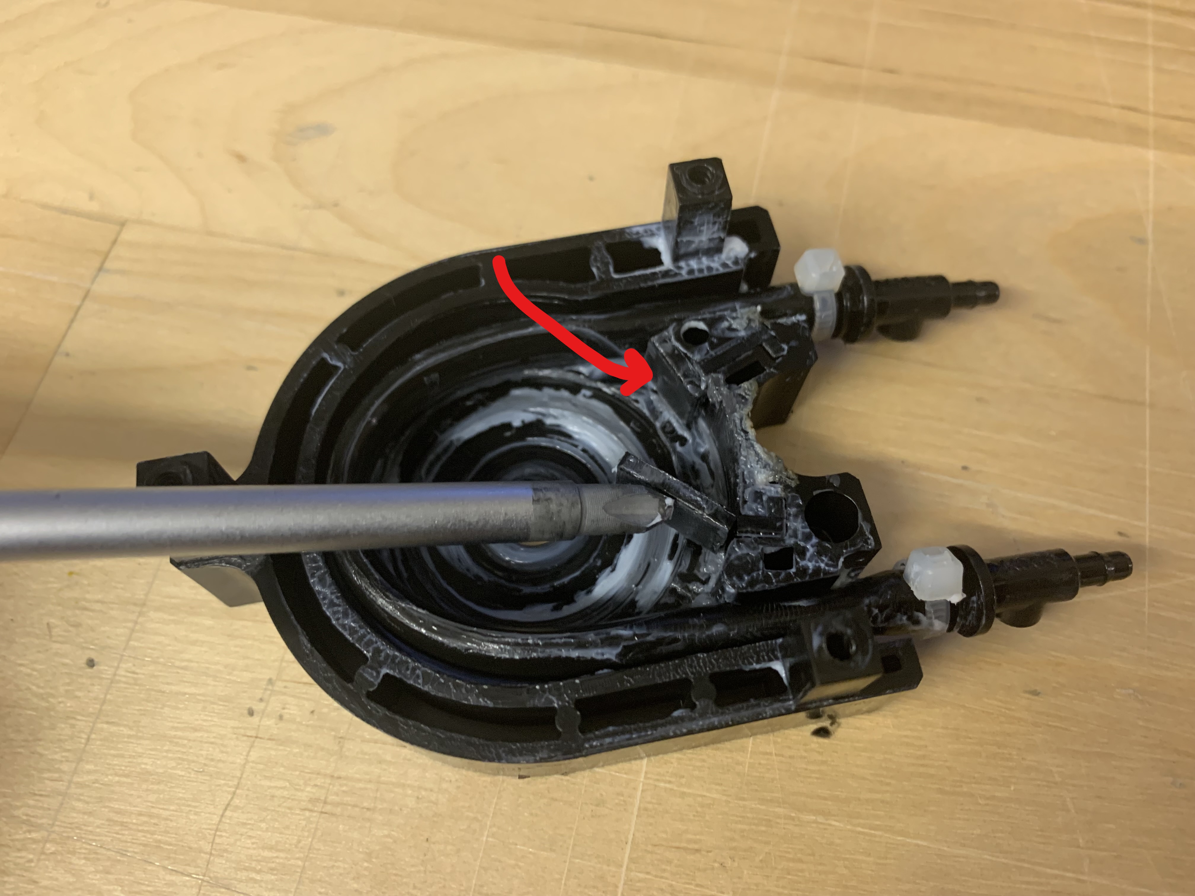

I've had a chance to dive deeper into the malfunctioning pump and thought I'd share with the group. After fully cracking open the pump, I discovered what I missed in my quick initial peek. There are 2 plastic tabs that are used to control the position of the rollers. It seems one was completely broken off and the 2nd was just flapping in the breeze. These tabs are what force the rollers to their outer most position to engage the tubing when the pump is rotating in one direction. So, in short, the rollers were never making it out to the tubing and so no ink could be pumped.
Assuming these pumps were never replaced, that yields a lifetime of about 1980 hrs. I'm sure individual mileage may vary, but if your machine is getting up there in hours, you may want to be proactive and replace the pumps (or at least have a spare on hand). Peristaltic pumps are simple by design, so not many components to fail, but these additional parts that Roland added to their design happened to the be point of failure.
On a side note, I figured for near $200 the pumps would come with a new motor - but no, just plastic. To pour a little salt on the wound, these tabs that broke are actually removable/replaceable, but Roland only sells the pump as a complete unit. What a great racket Roland has going on here...:p
