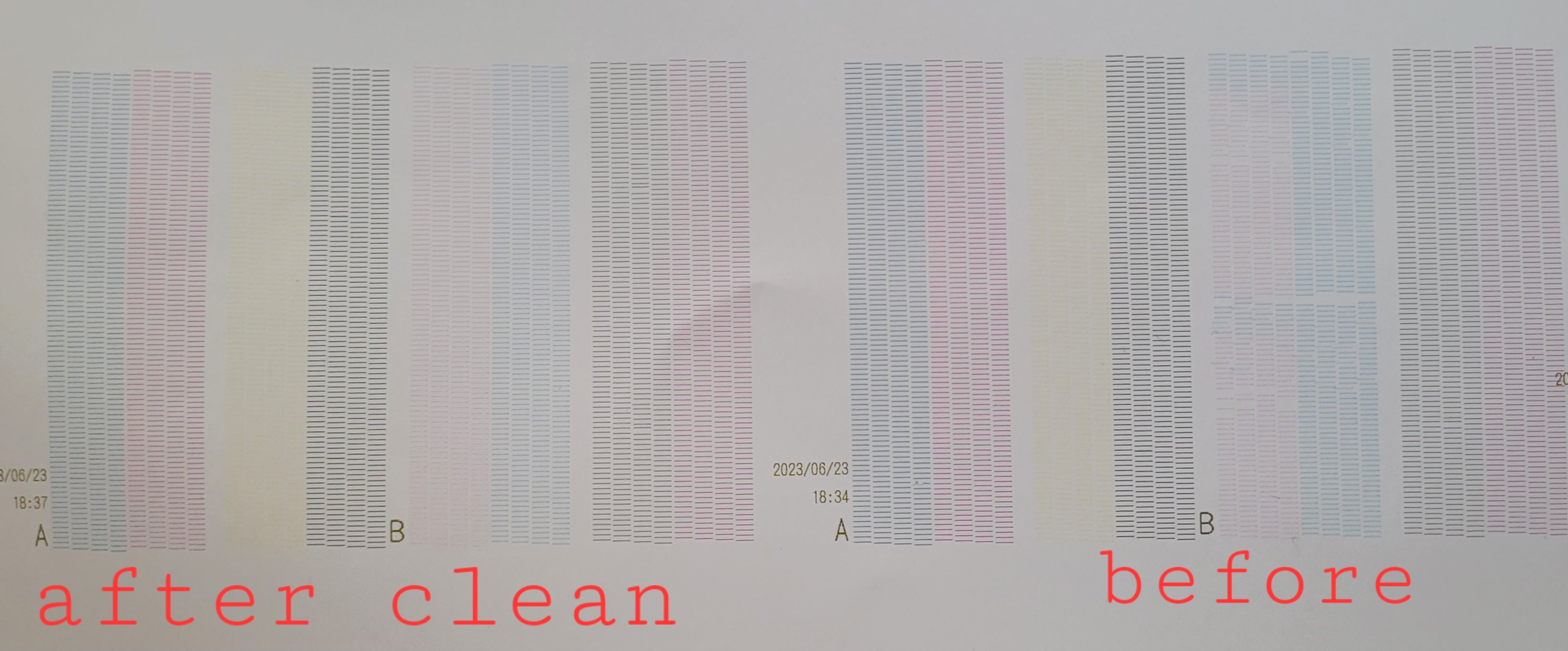

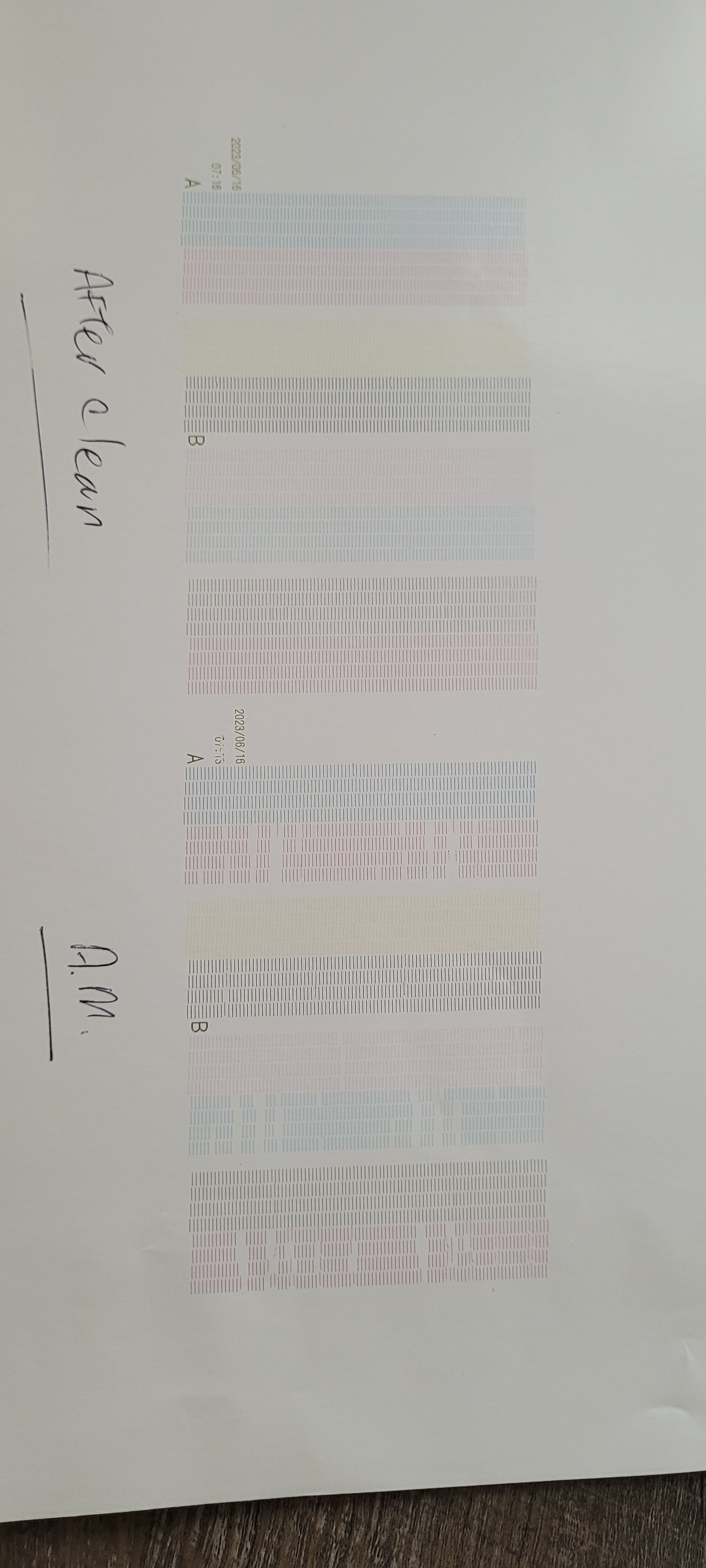

Every morning the test print looks like the attached and after 1 reg clean comes back perfect and prints like a champ. Replaced all captops and had the tech install and made sure it's seating correctly. Fairly new heads. It also used to jump from one channel to the next. Now its only on the light magenta/ light cyan. Tech says do a "fill damper" but I despise wasting ink with this VG. I look at it sideways and wants to clean! TR2 inks with firmware upgraded. I wish it would clean once a night like my old XC-540. Almost every time I load material: clean. Test print: quick clean. I just watch the waste bottle fill up. Geez. Wish i could change the firmware somehow. Back to fill damper: How does that correct this type of problem?

Have you tried printing with just that little bit of Cyan missing?
I would think it would print OK.

I'm not saying to let it ride. I have had similar problems in the morning, printed all day, ran a test print at the end of the day, and it was gone for the next 4 weeks.
Sometimes these slightly irregular test prints appear then disappear.
What does your printing look like with the few missing nozzles that you have? If it's not super good, print on high quality in VersaWorks.
That looks really minor to me. I have 3 Rolands, been running them since 2010.

Prints look fantastic after 1 clean in the a.m. ..just when it sits overnight, dropout occurs. But the heads always have a perfect test print after that first clean. Just racks my brain to why.

2nd update! The problem I thought was solved but still having dropout on test print exactly as the first photo in this thread and comes back to perfection after a "normal" clean. Each morning while sitting overnight -same thing, dropout and 1 normal clean looks and prints great. As stated before new Roland captops (even switched captops) new wiper. head is aligned perfectly and resistance when pulling gently with syringe. Not sure this is an air problem while seated on captops? The tech says the dampers are good. Otherwise wouldn't I have dropout on both heads on the test print? Should I try replacing the lines to the pump? I cant imagine the head being faulty as it prints perfect after a clean and has a perfect test print. If the head was faulty would the issue happen at all times where dropout remains? Should I replace lines, pump and damper for that channel? Racking my brain on this one.

If not captops or dampers, could be a cracked manifold. Leads to dropout and gets worse over time as the connection between the damper and head isn't sealed properly
