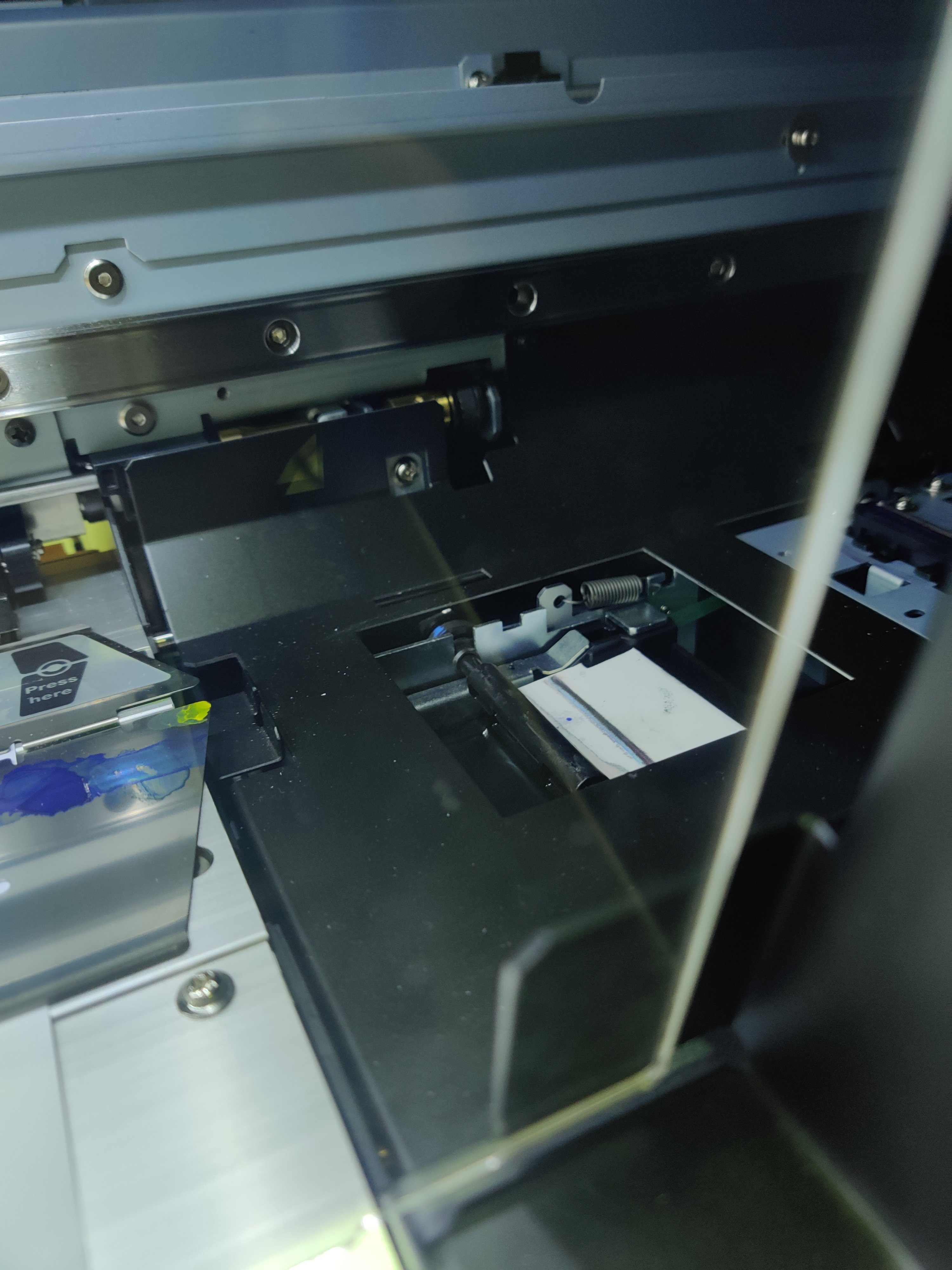

I could of sworn the printhead wiper of my VG2 was always facing up. I tried watching the printheads going over the wiper while printing, but couldn't see much.
Is the wiper supposed to be up or down by default?
Jester
Slow is Fast
It rotates up for head wiping and during manual cleaning, rotates down for automatic cleaning against the sponge.
