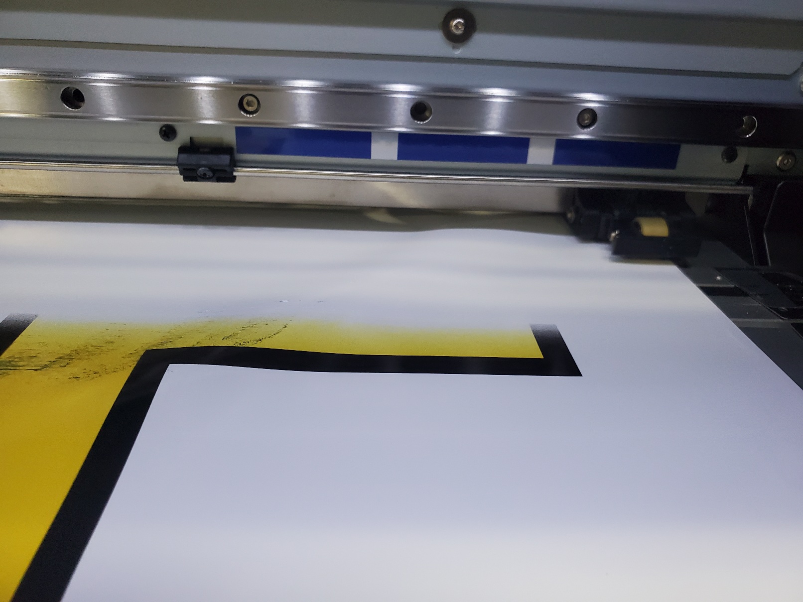

This buckling of the vinyl is happening on and off. it does it both on and off of the takeup, so its not a tension issue with the takeup. Machine is a Roland VG2-540. media is Arlon DPF 4600 GLX. I have been running Rolands for years and never had this issue. It will work fine for yards and yards and then start up again.

I have been having the same issues. I've been wondering if it is a humidity issue, heater settings, or a different backing paper. It seemed to have started after the Covid related shortages. It doesn't seem to happen with the other materials, only the 4600. I use a Mutoh VJ-1624.

First step would be to clean the grit rollers and pinch rolllers. I get this occasionally and find pulling the vinyl off the roll before starting the job helps as well as it isnt then having to drag the weight of the roll. I think sometimes the vinyl can sort of stick as it is being fed off the roll and this can cause it

We don't run that particular media but I have received other defective rolls and it kind of sounds like the media may be the issue. Is the core deformed at all? That's usually the biggest culprit when our Roland has random head strikes on a particular media.
Beyond just the core being deformed we've had lots of random issues with media of every kind since COVID. You can contact the supplier you bought it from and ask if they have had others report issues and see if they can get you a replacement roll from a different lot. Usually they're quick to send out a replacement, but you do have to keep on top of them to credit you for the return.
On that note, I've been retaining the boxes for every roll of media since we started having supply chain issues because they always want the lot number if you suspect there is an issue.
