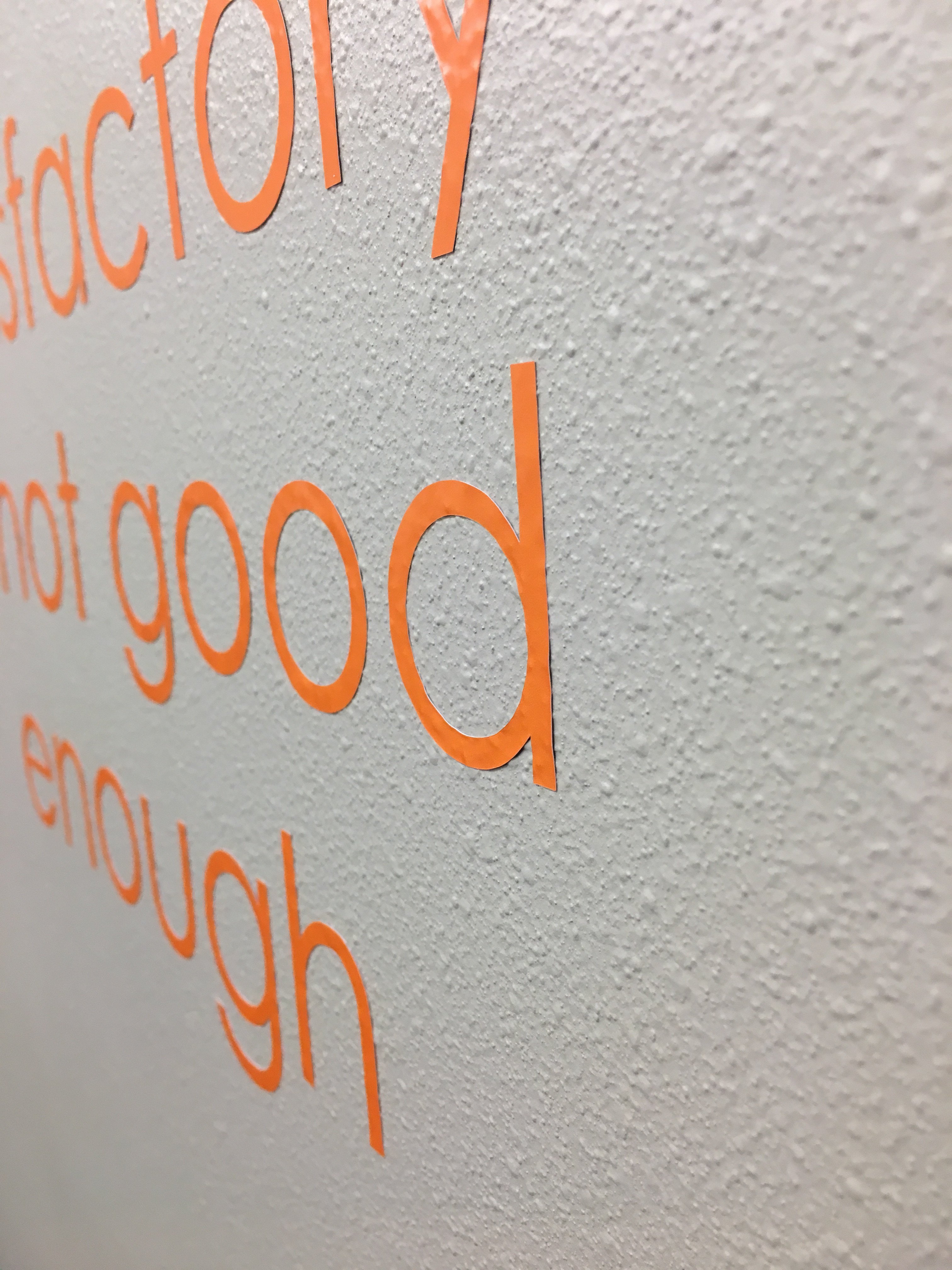

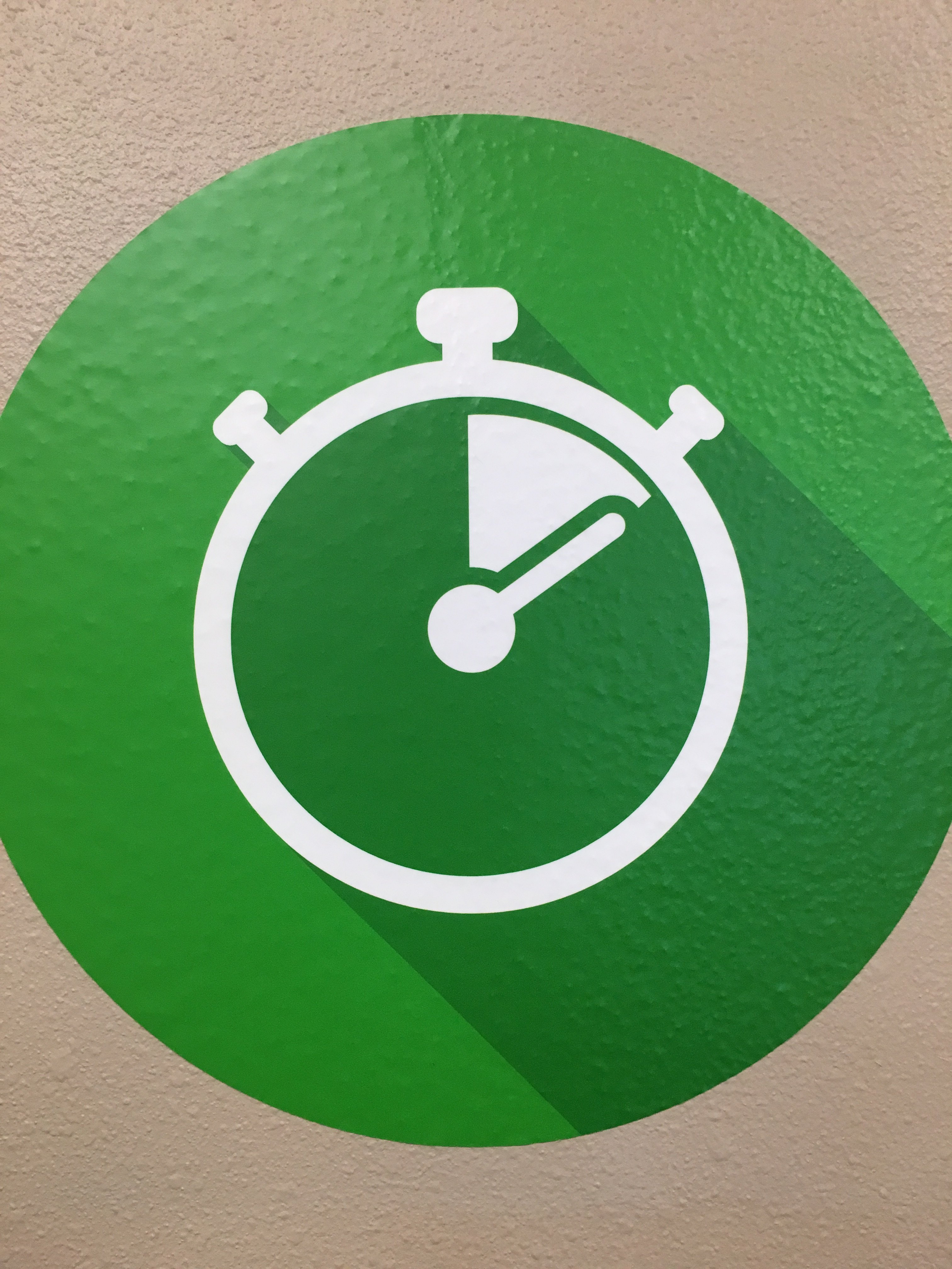

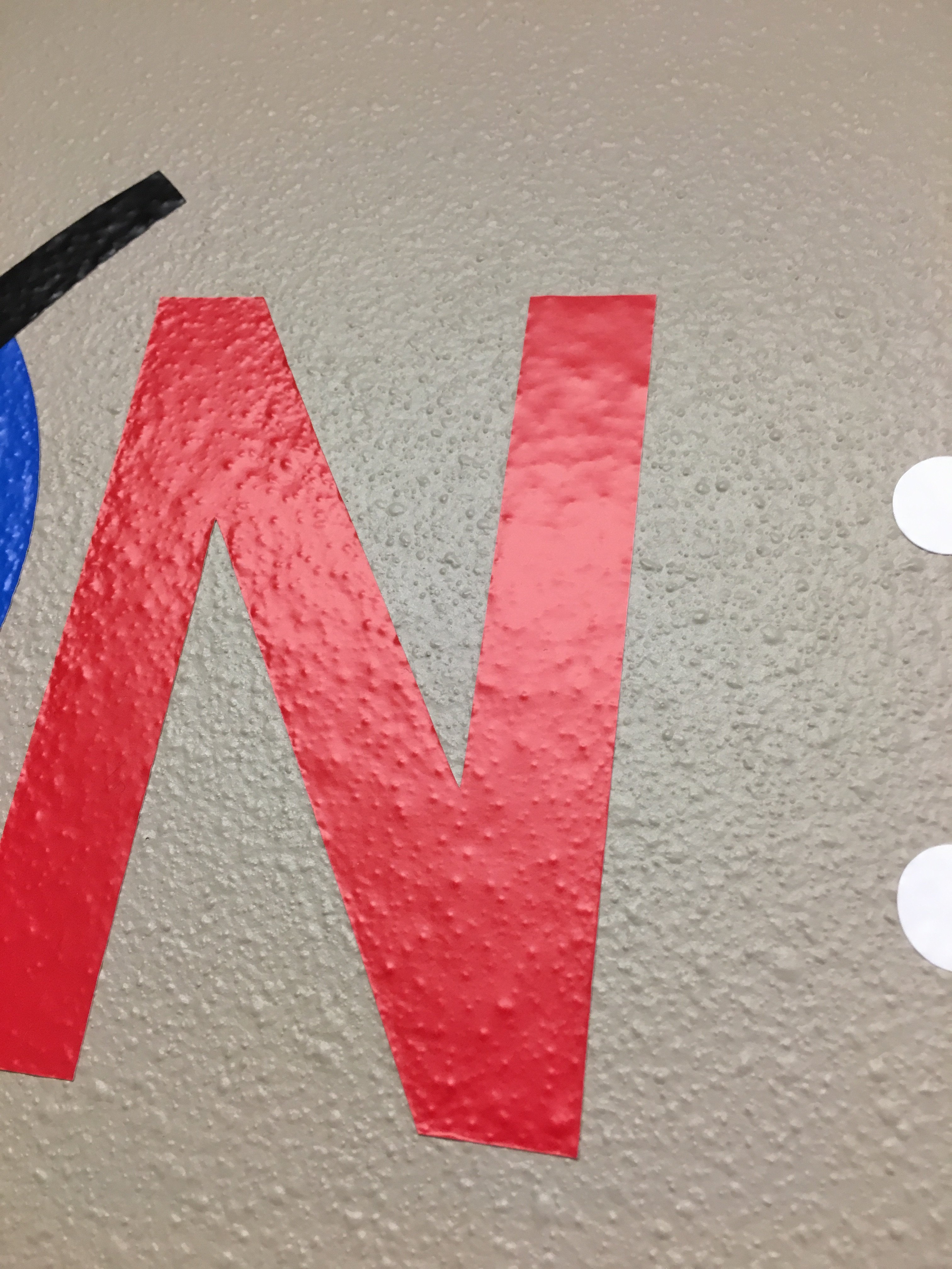

Using Avery 2105 ezrs. 3m 8050 lam. Keeps coming off paint. Tried using heat. No help. After a while starts to come off. Any tips? Cleaned with 70% iso. If I have customer repaint. What paints do you recommend. We did their location and it stuck perfect.

That wall is far too textured for standard vinyl. We've gotten away with IJ39 on similar, but it wasn't as textured as that one.

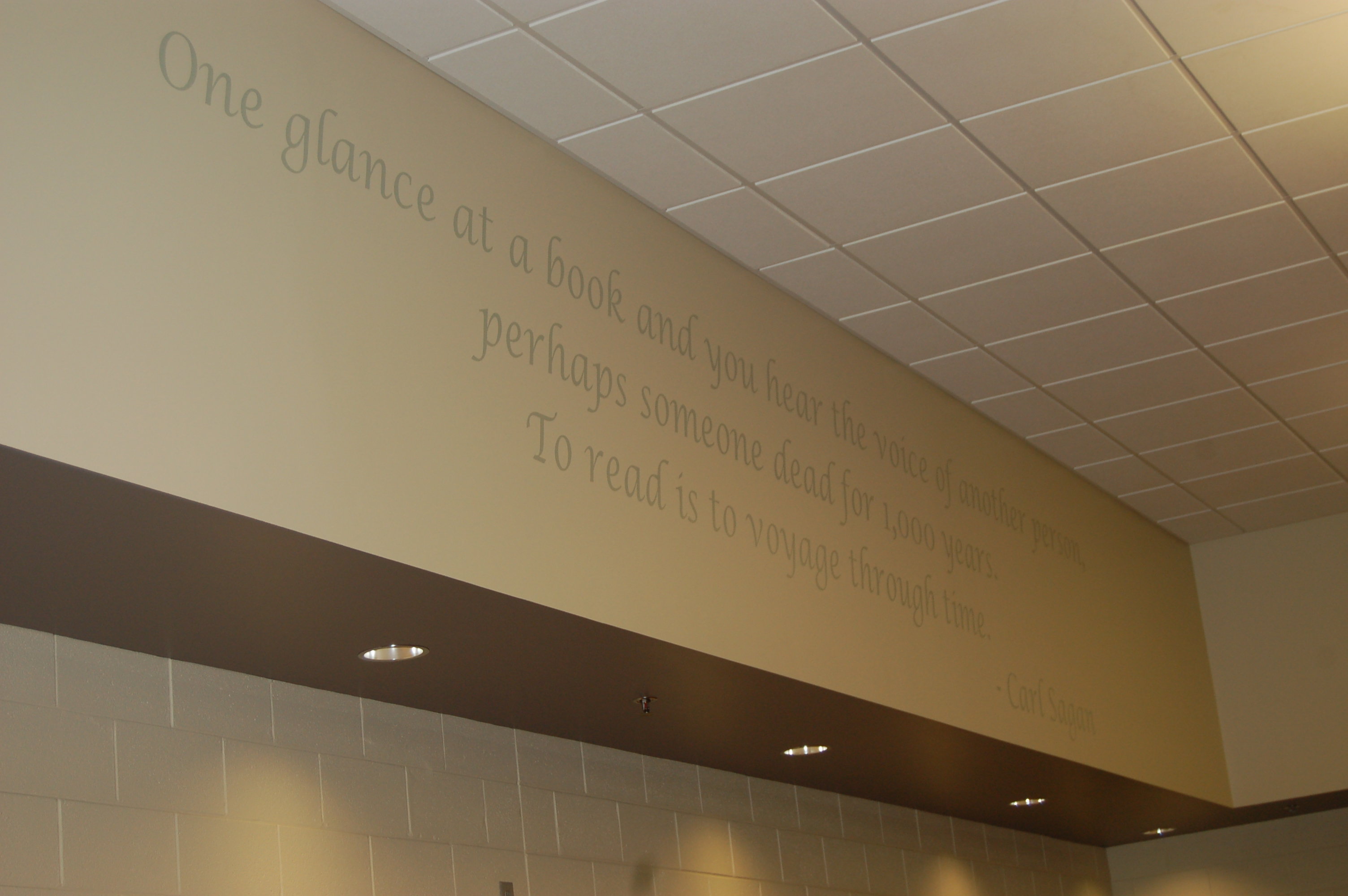

You can cut lettering out of DPF8000 just fine. When we have done interior wall lettering with it we have not laminated it. You don't want the thickness, and UV exposure isn't a problem. This is a job we did with that in a high school library.

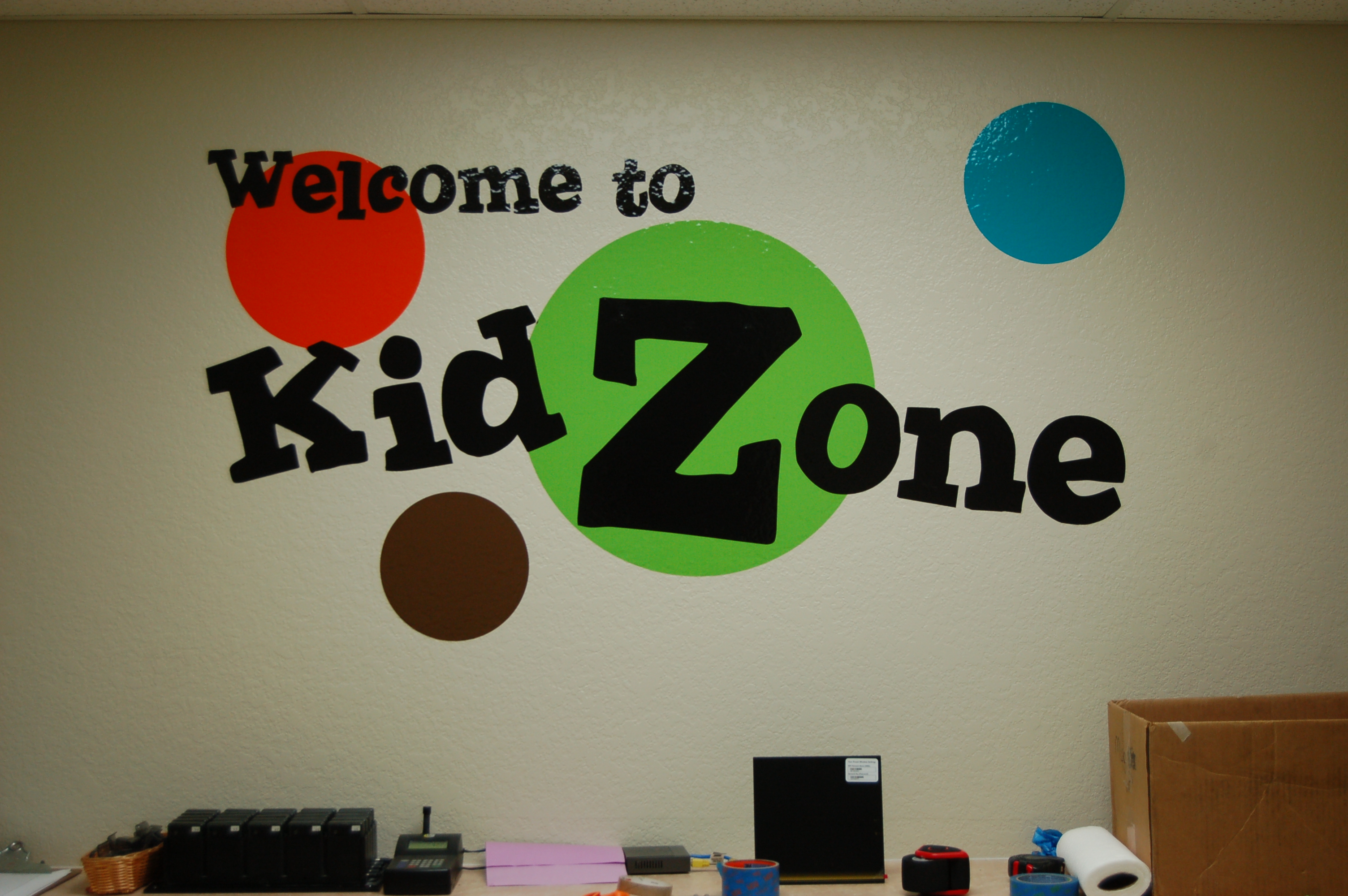

Here's one we did on a textured wall with DPF8000 but we laminated it. We had to heat and roller it because of the laminate making it so stiff.
