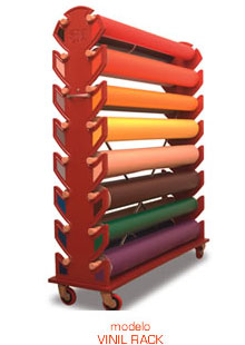

unmateria
Hi! Just store the printing media in the same room 24/48h before. Dont store vertically either. Its much better from inside the roll. In some shops is better to stop printer heaters too if that room is too cold. But usually with this, it works
