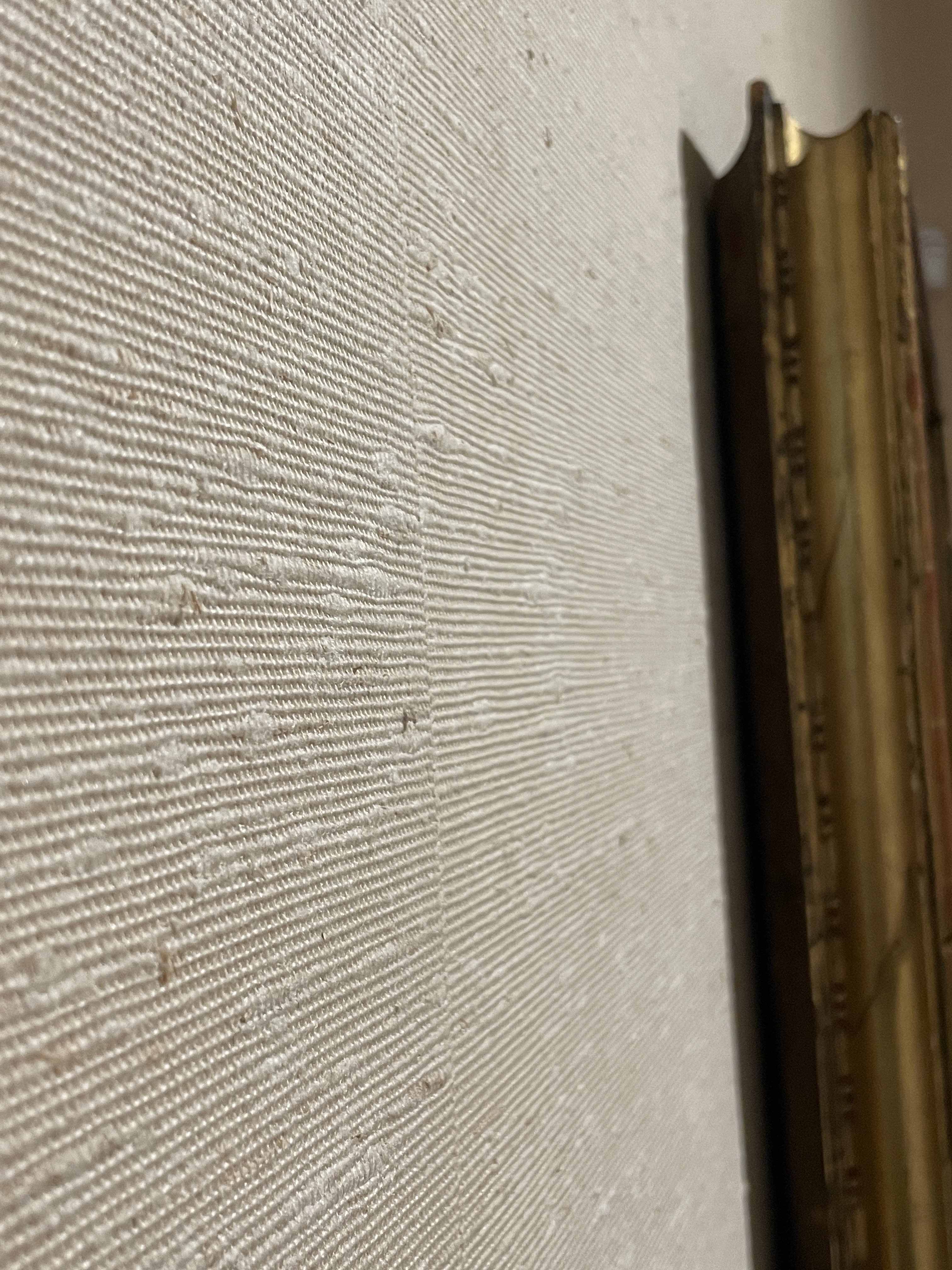

Hi, I'm a graphic designer and have only used cut vinyl lettering a few times, so I was hoping to get some advice
My client has requested vinyl cut lettering for a large wall quote in a room for an exhibition (which will be up for 6 months). But the room has a textured fabric-type wallpaper.
I’m wondering if anyone has experience with vinyl cut lettering on textured wallpaper like this and could advise on whether it would stick well. The letters will be quite large (Proxima Nova 130pt).
Alternatively, I’m considering printing the quote on a vinyl-wrapped Foamex board and hanging that instead, but not sure how nice that would look.
Any help or advice is much appreciated—thank you!

Ah nooo, i thought that would be the case! Already warned her that i doubt it would work, so thank you for clarifying.
It's 63 words long (apparently it cant be cut down at all), so may be a bit too complex for the pvc, but thanks much for the suggestion! I'll try and convince the curators for it to be included in a different way.
