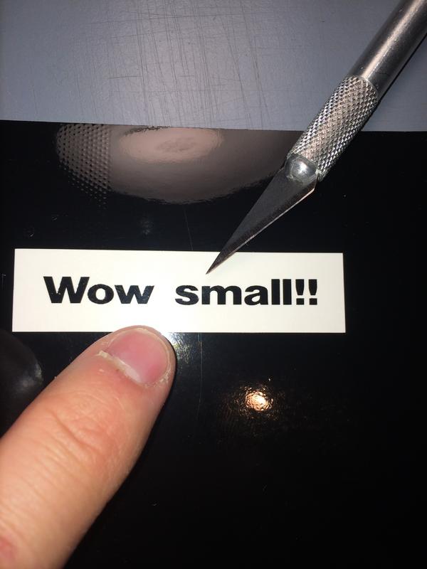

With a dedicated pro cutter, Graphtec, Summa, Roland - that is dialed in ( blade type, depth, pressure, speed and material) you should be able to get good results. I have had success cutting small designs for several years-- this was a test on my FC7000 a while back.
attachment.php
