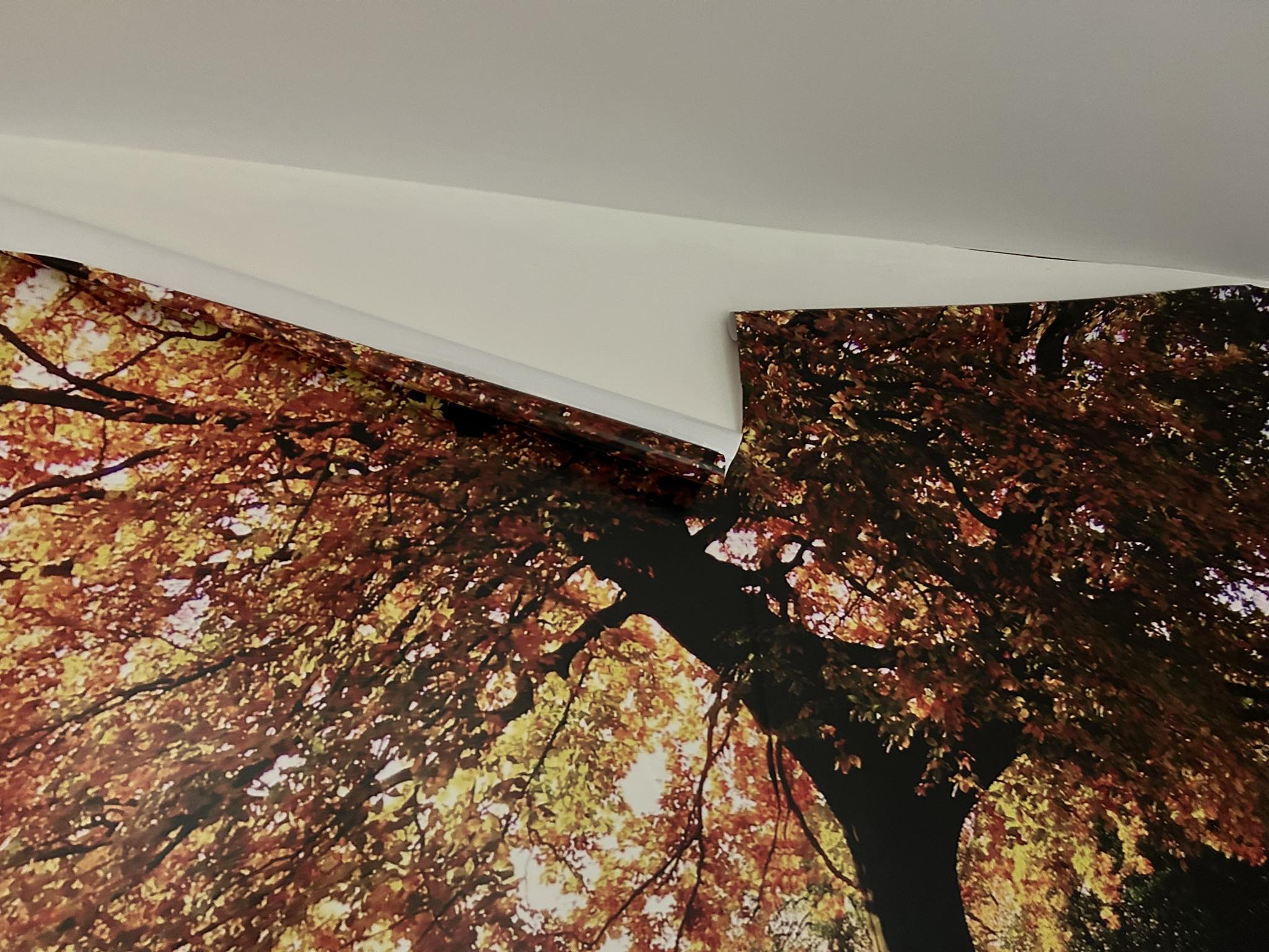

which vinyl do you use for wallpapers?
im using oracal 3165 and 3164HTG + 210SG or 215SG.
sometimes clients return to me, because vinyl pell off. it ususally start to pell off in corners.
i always apply it on fresh, dry painted wall, and sometimes it holds well, but sometimes it start to pell off...
what could be the reason? 3164HTG has really strong glue and it started to pell off...

A lot depends on the paint. Full cure on paint is usually 30 days - that is off gassing has stopped. Best to always do a test to see if it will stick or which to use. We have used 3164HT Mac Tac Rebel 528 High Tack, and General Formulations 226HTR (high tack and removable, love this stuff) and 234 Wall Fabric. We put one up with IJ40 3M vinyl that was provided to a customer that is a part of a franchise - that went on freshly painted and stayed well.
Wall must be cleaned as it usually has some dust on it. Applying a bit of heat can help it stick - heat gun and a roller is what we use.
3164HT is a good material, but may not have been the right choice for that wall. (Even 3M recommends testing before choosing a vinyl.)
Hope that helps.

See if you can find anything similar. Vinyl will give you grief as to where the non vinyl solutions tend to fare better on painted sheetrock.

does alcohol cleaning do much? i have never cleaned it with alcohol... i use dry towel if there is some dust, but if it is fresh wall, i dont clean it at all...
why 3164HT isn not a good choice? isnt stong glue most important?
