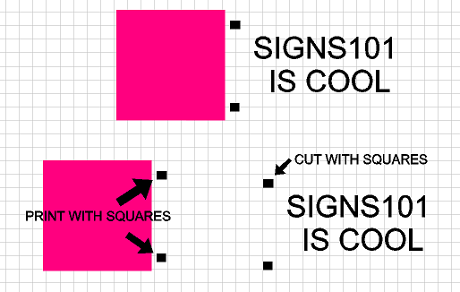

Dumb question. How do you go about lining up this logo next to the wording so it's dummy proof for the client who will be installing it?
The flame logo is to the left and the lettering is to the right.
Normally, I would just give them a full sheet of lettering so they can apply it themselves.
Stacey K
I like making signs
Or you can use a couple squares. Print the squares and then also cut with them. The client can then line up the squares and it should get them close. I would make sure to tell them to double check the lettering to make sure it's straight but lining up with the squares will get them super close...just some fine tuning with a tape measure.
Pideas
The pounce pattern should do it. Thanks, Gino.
