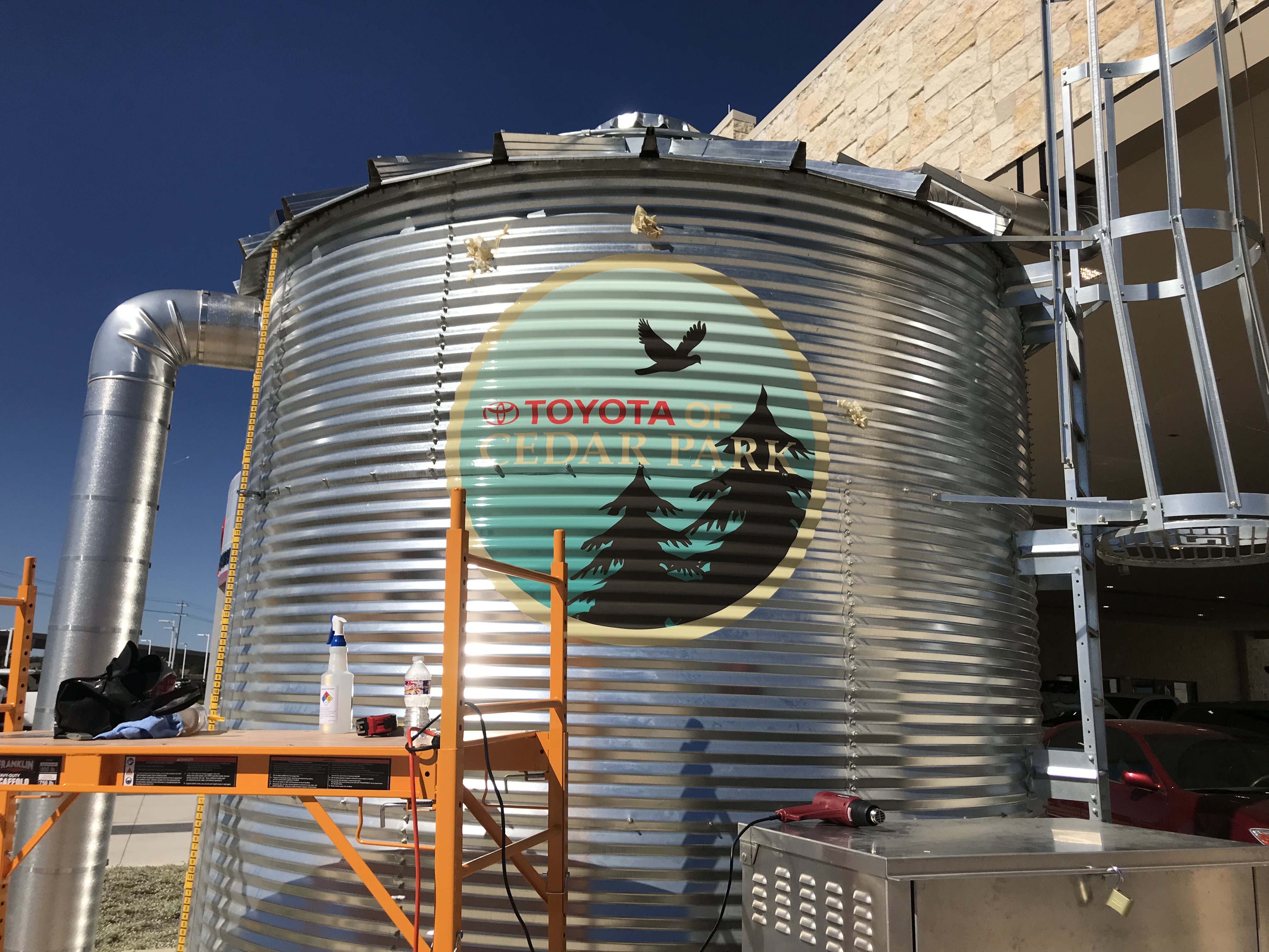

since you will be doing 2 prints, install the first but dont fully tuck it everywhere yet, install the second the same exact way so that the top and bottom start and stop about the same place. once the rough install is done, heat and tuck as needed. then make sure you do a post heat on it

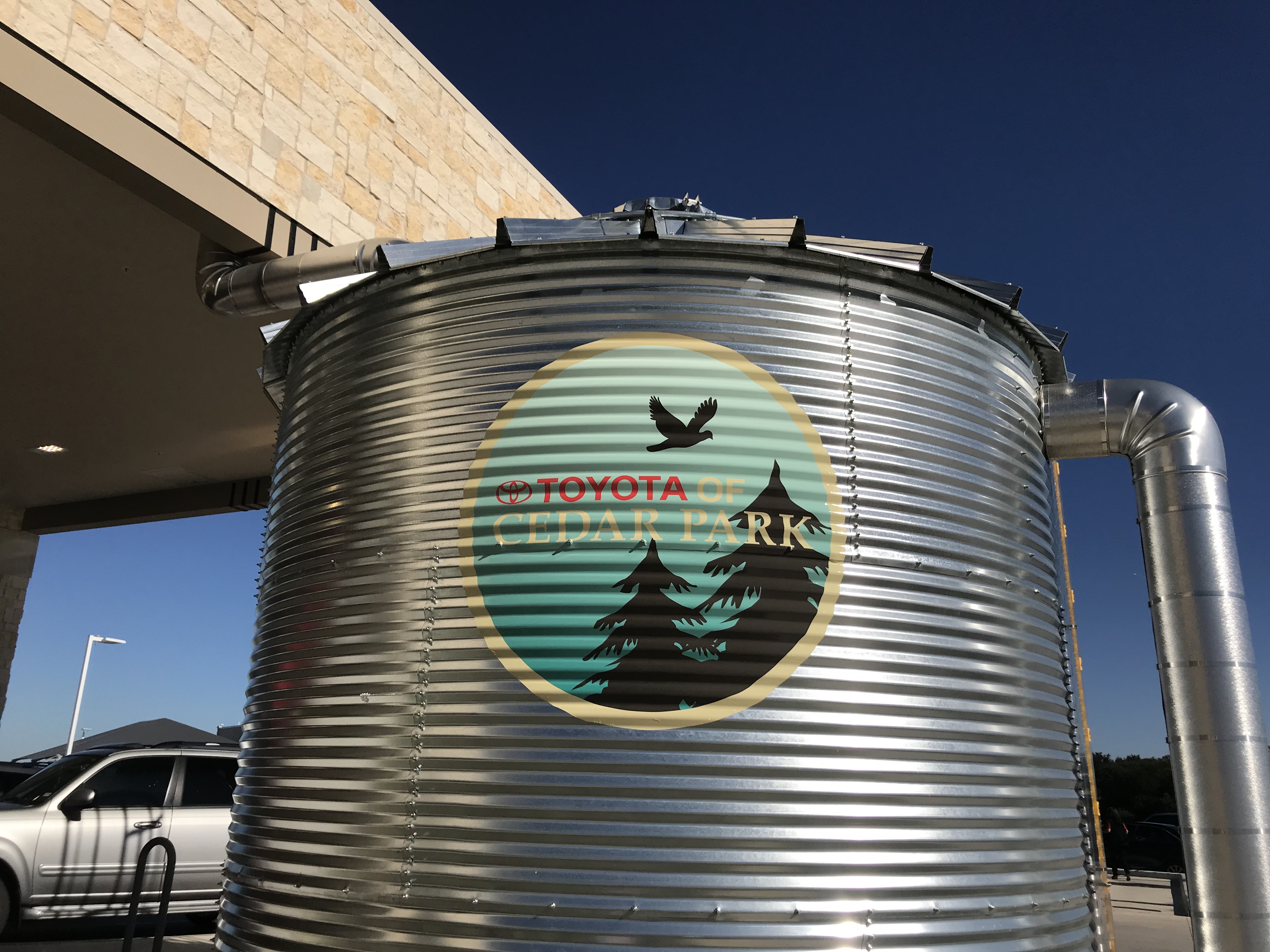

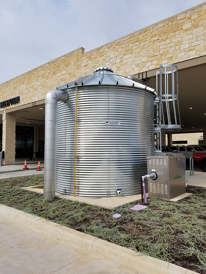

And here's the finished job! We actually ended up doing a 52" circle so I didn't have to do them in pieces

At 30% smaller, I would think it wouldn't present any of your earlier concerns. However, that thing is very hard to read. Did you know that when designing it.... or did someone tell you what it had to look like ??
We told them how it would look warped. I even photoshoped the graphic on a pic of the cistern with a displacement map to show them the distortion. Heck, I even took a section of the graphic with the words and applied it to show what it looked like. Also, we suggested using a more contrasting color than that tan but that was their design and they wanted those colors. They might want to end up going bigger after all, we'll see

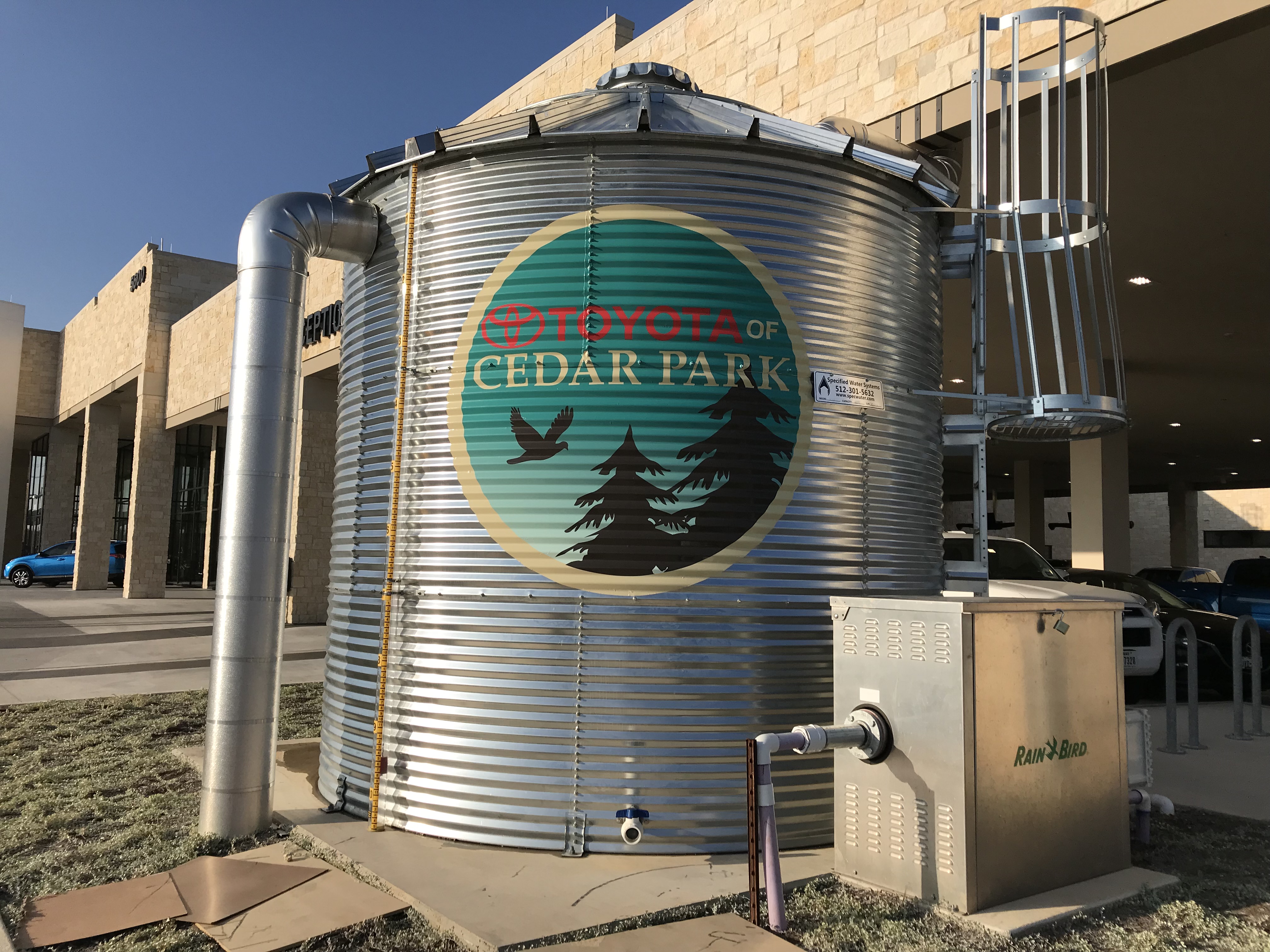

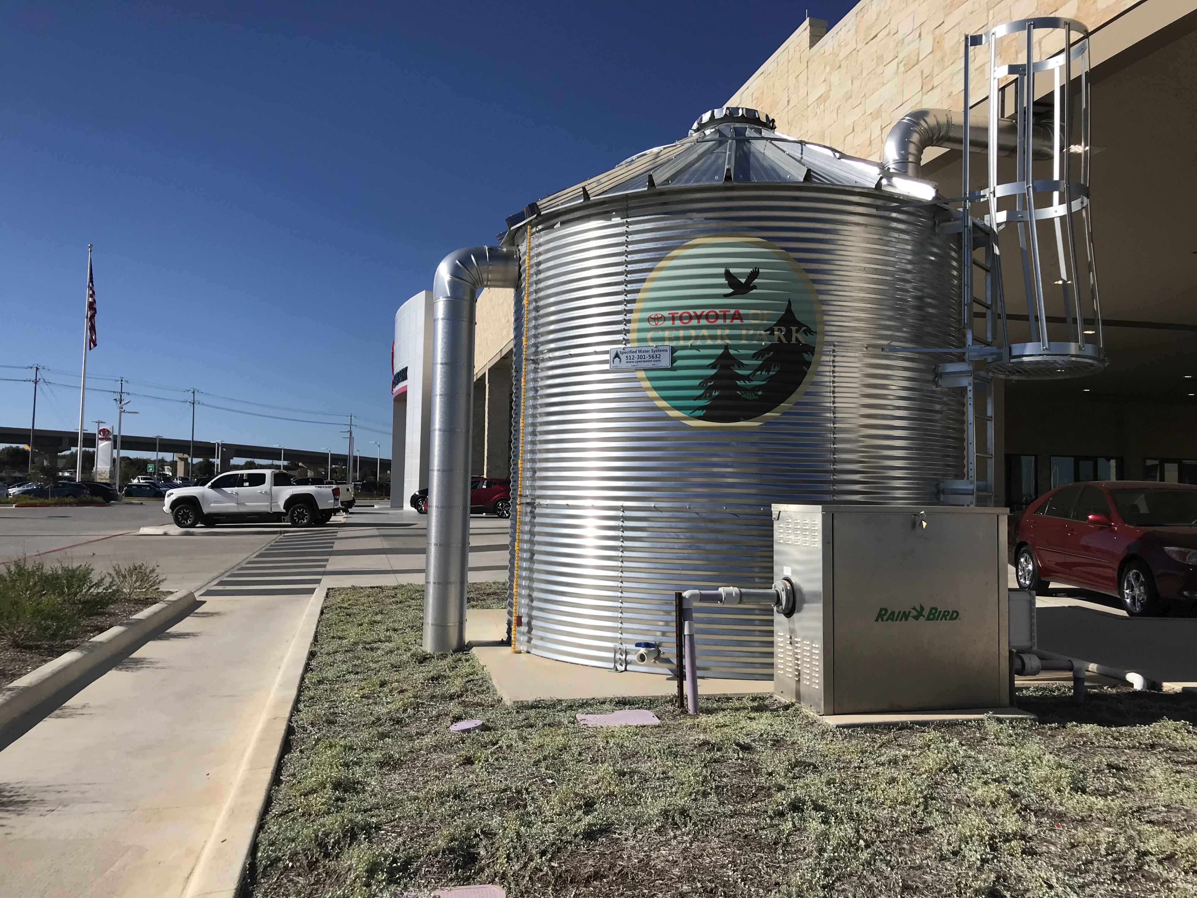

Well, just thought I'd update this. So Toyota wanted to go bigger so I went back and peeled the old vinyl and replace with a 6 ft graphic in two pieces. Pain in the butt and it was hot but got it done

What really makes it look a lot better is that..... you reversed the gradient and made it darker for a longer period of time.
I like happy endings. You didn't hafta eat the first two, did you ??
Nice job, again.​
Nice job, again.​
Yeah they had their marketing team change the logo for more contrast as long as we were replacing the graphic anyways. Thanks for all your input guys, pain in the neck to install but I think it looks really nice
Also, I didn't stretch the graphic vertically as when I tested the shrinkage do to the corrugation was only 3% and the circle didn't look off. In the most recent pic I posted, for some reason looks taller than wider but that must've been the camera angle
