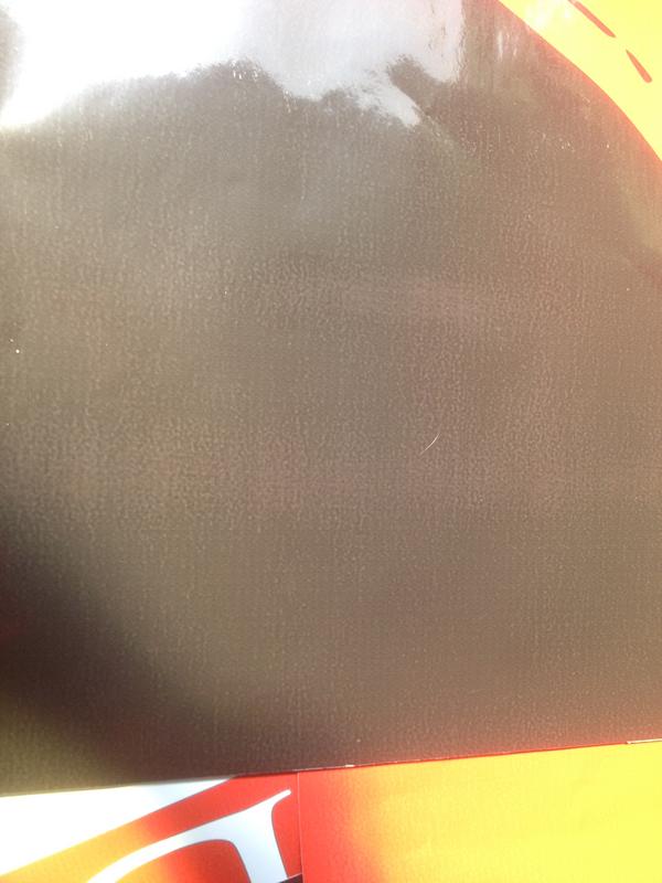

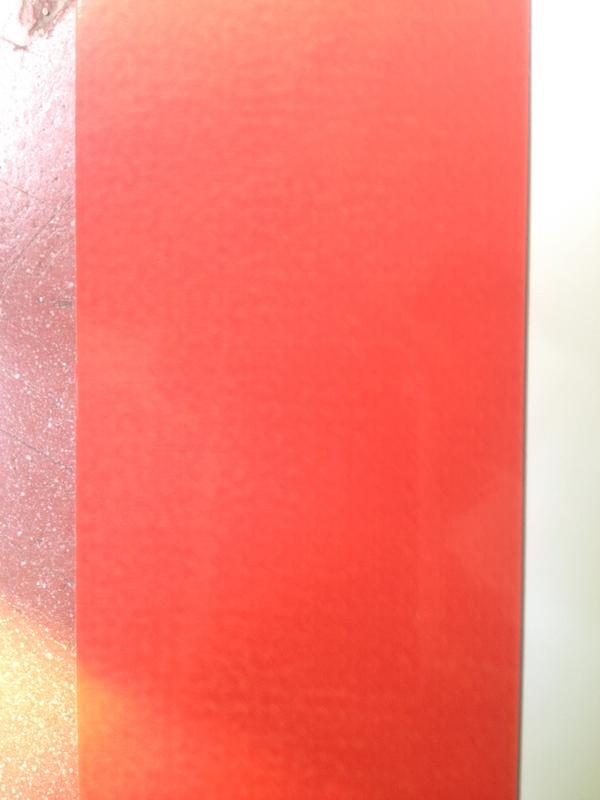

Hi to all, I´m having problems printing on vinyl.
I use colorburst generic vinyl speed 2 720x720 temp 31,35,50 C. they appear like white dots on the material i attach pics. so you can see any recommendation.
the first picture its should be black but it doesn´t look very good
thank you all

Some vinyls print better or worse with certain printers.
Try printing the same file on another manufacturer's material.
Most suppliers can get you sample rolls to test different products with your printer.
For some reason MacTac looks the best/smoothest on our Mimakis here, but we primarily print 3M vinyls.
sign girl
Material or File?
What kind of file was it? Garbage in garbage out if it was low res. Did you try changing it to 1440 x 720? Sometimes that changes things. Otherwise it is the vinyl.
