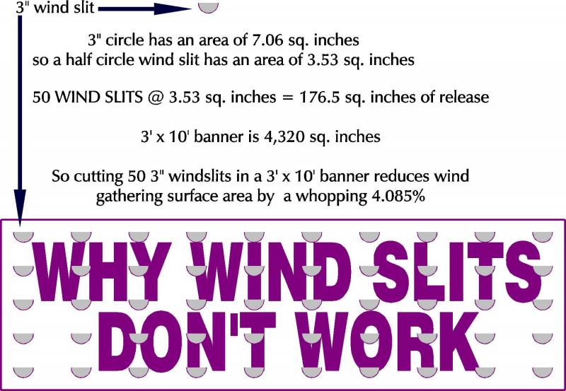

Here's the graphic I made several years ago that I send to customers explaining why I refuse to cut wind slits in a banner. On a 3' x 10' banner the reduction with wind slits is only 4% with 50 wind slits. Just not worth the minimal savings in my opinion.
And because I'm bored...and curious....
If Force can be figured as Force = Area x Wind Pressure x Drag then a 10 mph wind hitting a 3' x 10' banner at a perfect 90 degree angle would provide a maximum of 66.2176 pounds of lifting force. The same banner with wind slits provides 63.802 pounds of force. :thumb:

OK....I looked at your attachment and agree with you calculations......
but I am not sure if that is the question , that the total square feet is the only thing ,
I am not an engineer , I wish I knew one to give me the "engineer" answer ,
But I would think lowering the pressure by letting the air thru has got to be good for something !
Any engineers out there ?
