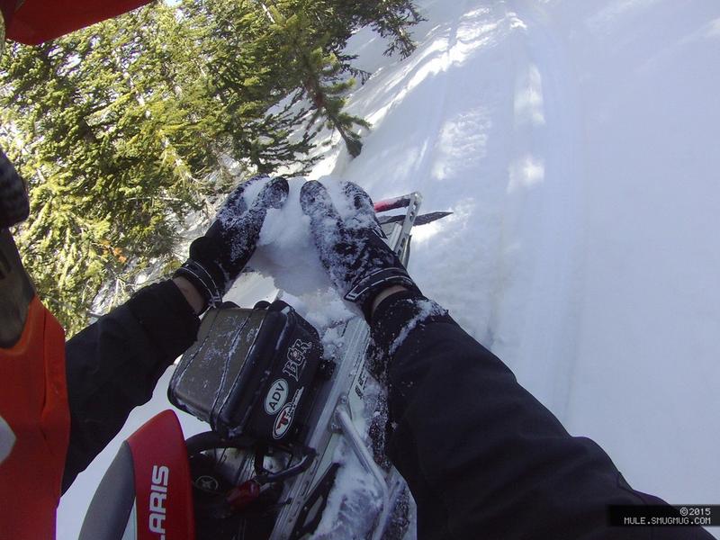

Get Lucky
Convex dose well with plastic. I also have some Oracal 3640 on one that has been on for about two years. The case is mounted to the tunnel on a snowmobile
