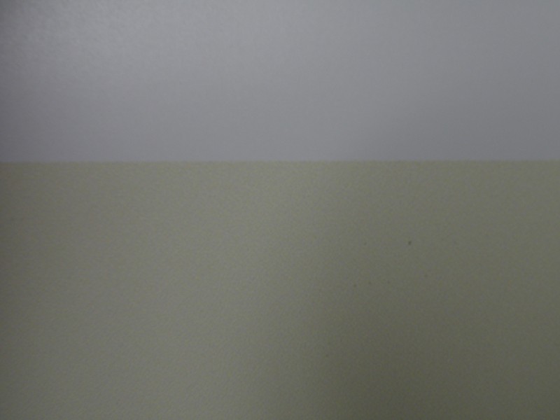

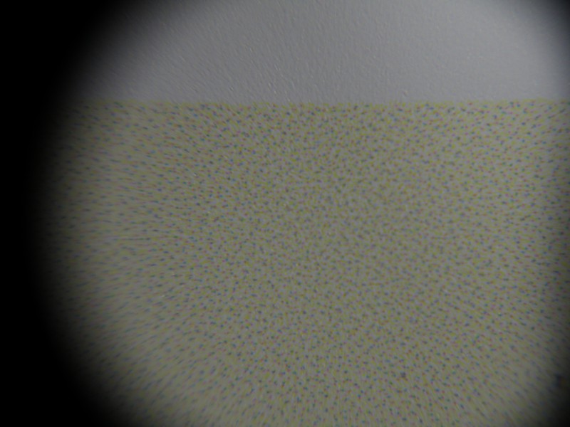

Does anyone know why my 1204 prints magenta and cyan as well as yellow in a fill that's supposed to be all yellow?? I'm trying to match an off white, and in doing some test fills, I designed several fills, some of which I assigned 3 - 15% yellow fills, no C, M, or K. I'm using Flexi Pro 8.5, assigning the fills right into the editor.
Notice the images below, about the best I can explain. This fill is assigned 0C0M8Y0K. But it has several specks of magenta, and even more of cyan. Thus giving a green look, which I CAN'T have. Second pic is really poor, but might help explain a bit.
Any thoughts on this? I really don't know too much about the printers (too obvious?? :) ), maybe I'm missing something really simple.

When using color correction the RIP interprets your CMYK values and applies a correction based on multiple factors. So if you send 100% yellow and 0% everything else, the RIP will actually add a little bit of the other colors back into it which is why you can see the little specs of cyan and magenta in there. This sounds counter intuitive but if a profile is calibrated correctly, those little specs of color actually help make it look better on certain materials. Most people however are using boxed profiles so they aren't optimized for their environment and vinyl which can make these extra color dots more annoying than anything.
Look at the tabs to the right of the color correction tab in Flexi and one will be called color replacement. You can go into that tab and select your yellow from the image with the eye dropper and actually see how the RIP is interpreting it. In this same area you can override the RIP and input your own CMYK values. In this case you would input 100% yellow and 0% everything else and it will print pure yellow. You can also just do 80% yellow and it will have the same effect except lighter.

That is amazing, I've never seen that before until now. Thank you!!!! I'll assume the tolerance slider on the output will allow for slight variations. I'll give this a try.
