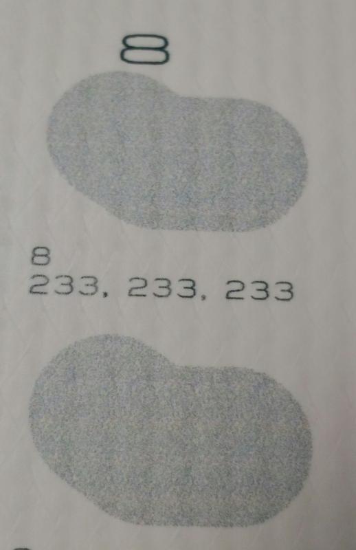

I used very little pressure when cleaning. Printing good now, what is weird ever since I got my printer I had the tech/sales man come back a few times to look at the issues I was having from the beginning, I would get specs of other color when printing gray that were noticeable and like I always had a little yellow specs in my red I know its in the color pallet but it was like contamination and he said that was normal, even when I would print the color pallet there would be specs never a true solid colors. I wonder if it was like that from new?
Jthompson Designs
if you look close you will see the specs, I have always had this since I bought the machine brand new.

I don't see any yellows or magenta dots in the test print on my end, I am not say they are not there but I can't see them. The fuzziness of the grey is probably because the print head is no longer calibrated since it was removed from the printer.
Jthompson Designs
I guess what Im saying is it is fuzzy and it has been that way since day one. if I print the pallet from the printer none of the colors are solid they all have a fuzzy look to them.
Jthompson Designs
How do I go about recalibrating the print head? That fuzziness has always been there since I bought it.
