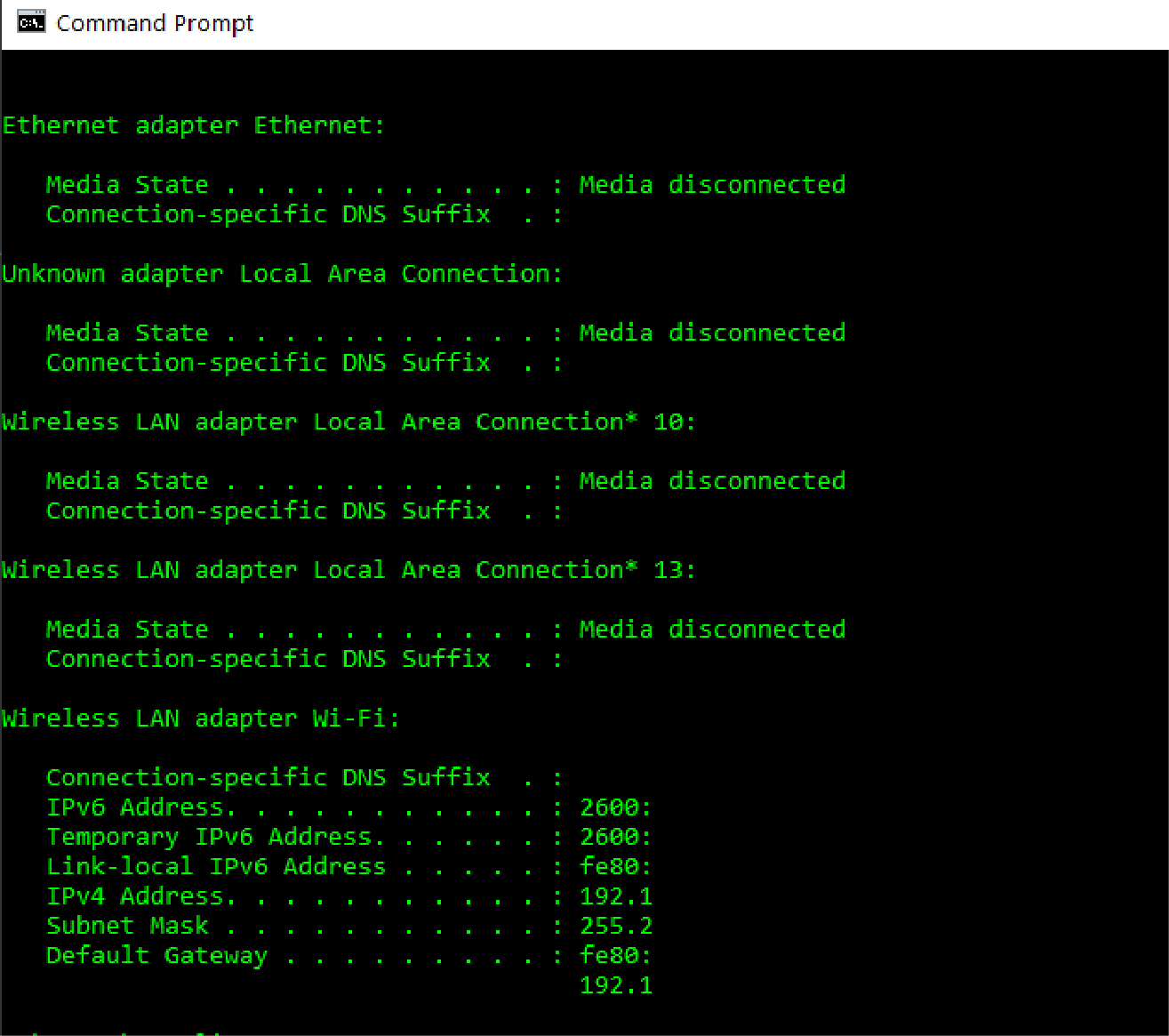

Thanks for your reply! I seem to be stuck at step 3, ethernet adapter settings.
Set Up:
computer --> wireless internet connection to router
printer --> ethernet cable into computer
turned printer on
(so the only things that have an ethernet cable: printer into computer...and modem to router.)
3. I'm seeing the wireless internet settings (IPv4 & Subnet Mask)...but no ethernet adapter settings? (or is that Default Gateway?)

That could be a sign that the cable, the ethernet port on the computer, or the ethernet port on the printer might not be working properly. Do you see any lights, blinking or solid, on either of the ethernet ports?

There should be an IPv4 address under the ethernet adaptor heading. Since there isn't, it means there isn't a connection being made between the printer and computer. So it has to be something keeping it from connecting like a bad cable or hardware.

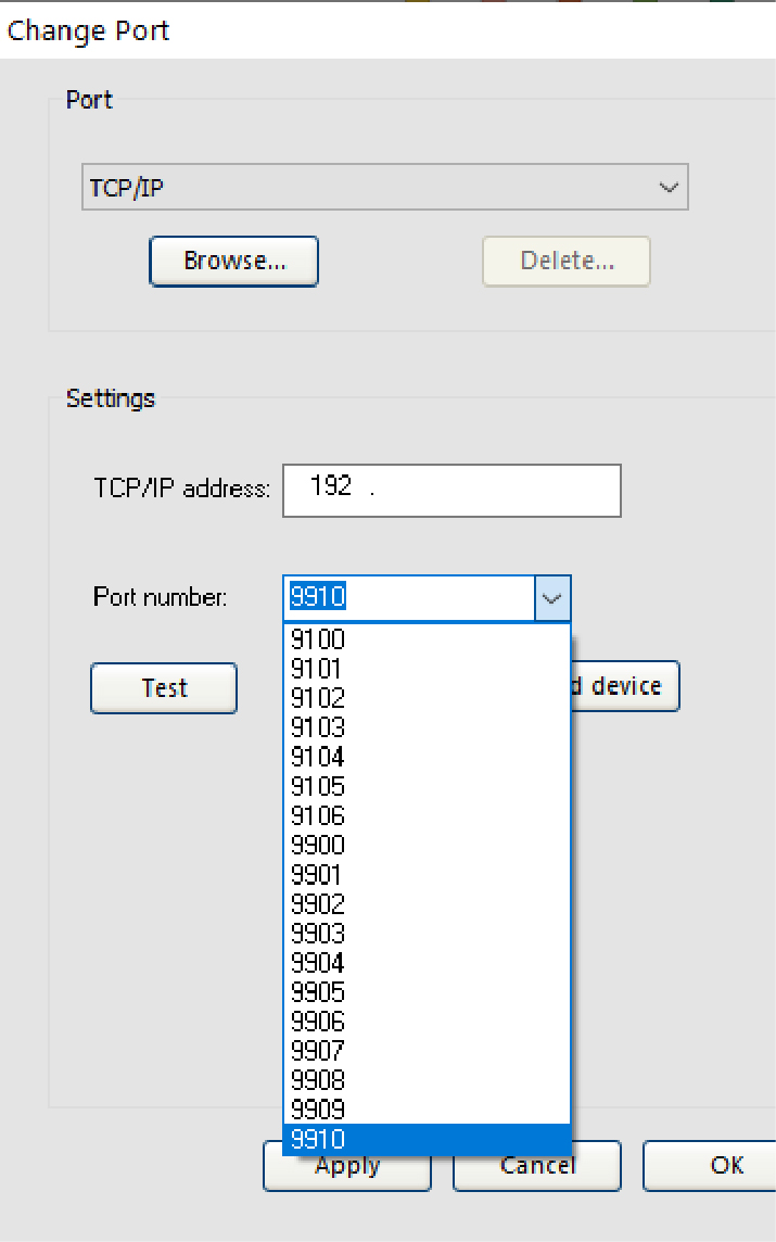

I don't see any lights (blinking or solid)? I swapped the ethernet cord...same error message.
However, I did notice in Flexi PM that you can choose the port number (attached pic.) Google search said to run "netstat -ab" to see available ports...and all that came back was gibberish. Nothing like the port format Flexi choices: 9100, 9101, 9102, etc.
To rule out a bad ethernet port on the computer, I'll try using a laptop later tonight. (Then, if the computer port is bad...maybe a USB ethernet port adapter would work?)

Sounds like a good plan. The port should be 9100 BTW.
