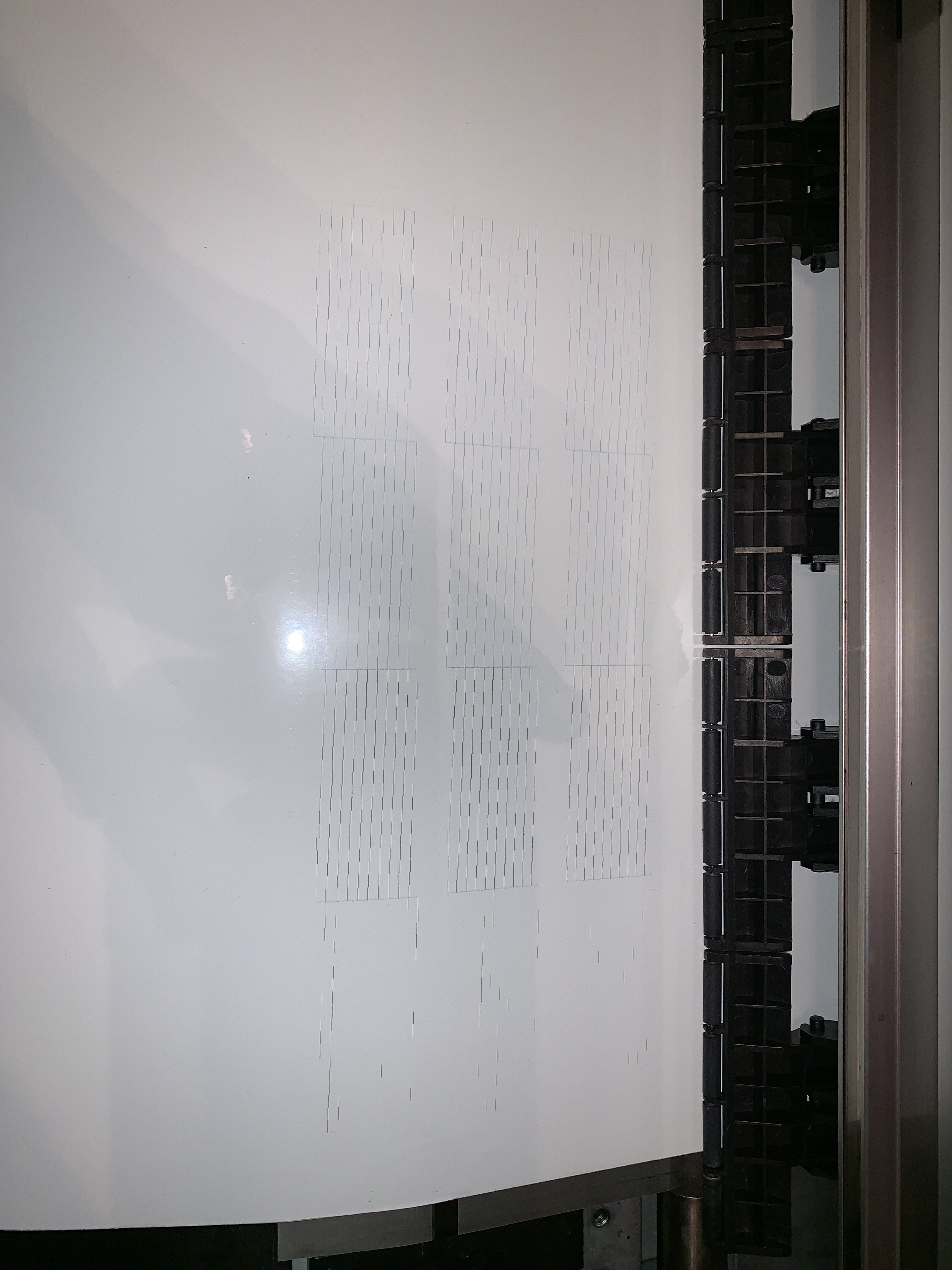

Finally figured something out. Do I keep doing cleanings to hopefully get cyan and black to work?
Curt Bullick
did you ever get your machine working properly? we are having the same issues with ours now. we have replaced the print head ,MS and bladders and still no ink. just wondering what you finally did to get it up and running.
Kelsey Adams
Yes I did. I replaced the dampers, pulled ink through the drain tubes and has worked perfect ever since. When I replaced the maintenance station, I did have to put the old black plastic thing on that the cap top sits in. That was the issue with the error code and head getting jammed. The head wasn’t moving smoothly when going on top of the cap top.
