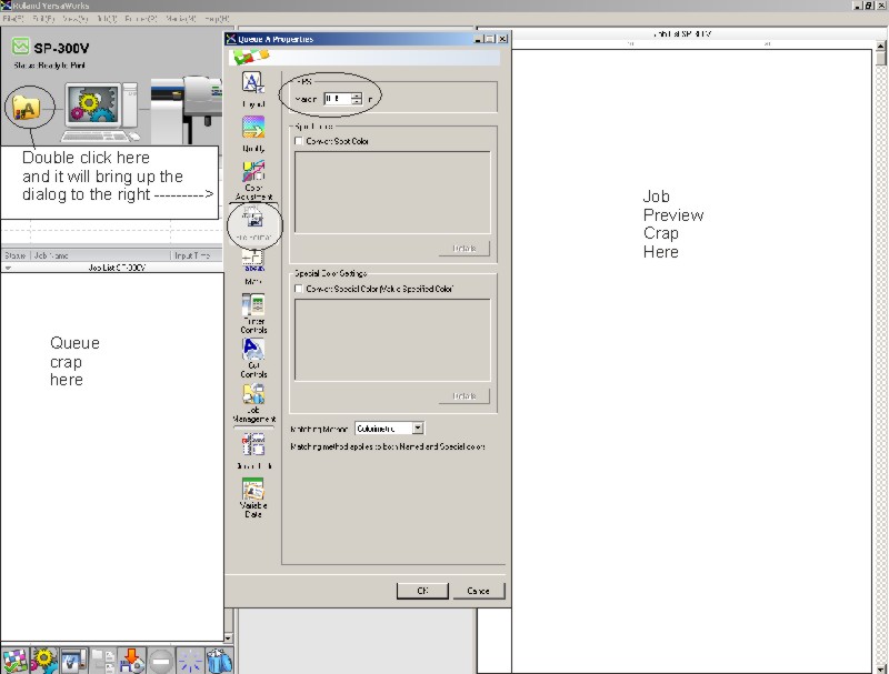

joeshaul
Attached a photo showing how I set my default EPS Margin.
Set your defaults in EDIT/Que A and or B, check ok to the settings you wish to have as defaults. When you bring in new jobs the defaults will be set...of course you can still change as you wish once the job is loaded
