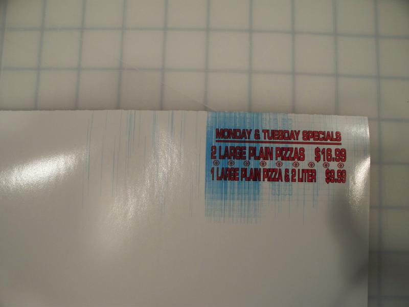

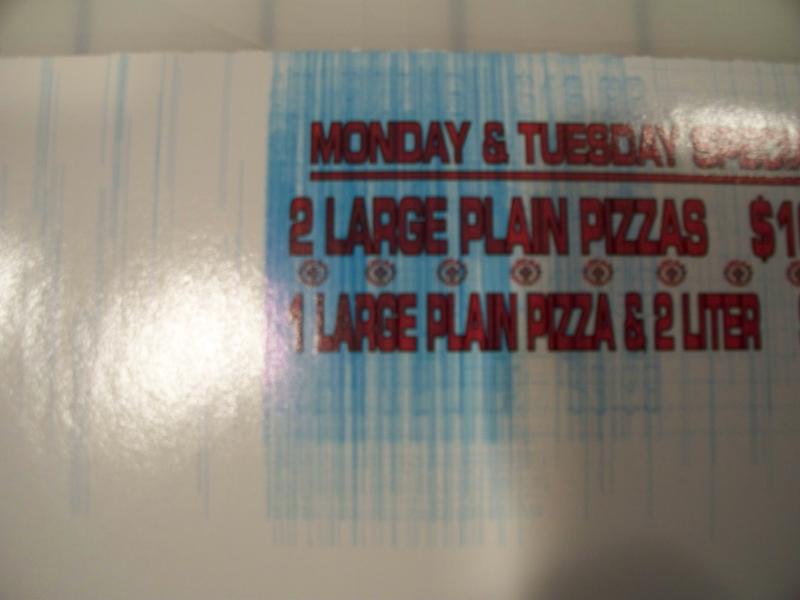

My VP is printing blue or cyan lines. I am printing from flexi 8.5 and also tried Verasworks v2.7.0. When I try a test all color bands come out good but also some blue lines appear. I clean the heads and replaced the wipers. Please help.

Nozzle Test?
Still having the issue?
Can you post a nozzle test?
The prints that you post don't look good at all. Looks too intense to be a weird static thing. Suspect a head board or even the head?
Any VP-model should be still be covered under warranty. Get a tech out there pronto.

Tech is comming out tomorrow and Roland tinks it's one of the boards. When you completely power the unit down for a while and restart most of the blue go away but some are still there. The nozzle test showed a little not much. Thanks for the info. This seems to shock them all at Roland.
