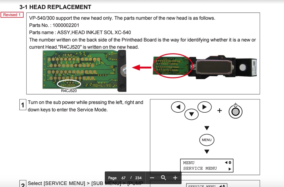

Hello, hoping someone can advise me on how to gain access to the service menu on a VP-300I. When attempting to hold left, down, and right while pressing sub power on the display reads service mode protected? I can't seem to find much of anything regarding this for this particular VersaCamm. Any and all help would be greatly appreciated.

Thanks for your reply. I'll try that. However that is not what the service manual describes. Well see what happens. Image 5-19-21 at 9.35 PM.jpg

I was able to get it figured out, incase anyone else ever has this issue and stumbles upon this. you have to press DOWN, RIGHT, LEFT, UP, RIGHT, DOWN, LEFT & then press and hold left down and right and push the sub power. Appears to be some kind of additional layer to prevent average joe from gaining access to service mode. I'm sure it can be disabled some how or other as the service manual does not speak to these steps what so ever.
