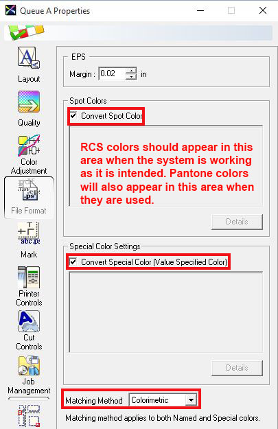

When you are wanting to print Roland Color System (RCS) colors, or Pantone colors, it is critically important that you set-up your Queue default settings properly. If you do not, there is no linkage and no color replacement that will occur. Here are the steps:
1. Edit Menu > Queue A/B Settings > File Format Tab. On this screen, enable the checkboxes for 'Convert Spot Color' as well as 'Convert Special Color', and make sure that the Matching Method listbox is set to 'Colorimetric'.
2. Build a file in the vector design tool of your preference, and fill the desired objects with Roland RCS colors. Bring the resulting EPS or PDF file into Versaworks.
3. Open the Job Settings dialog, go to the File Format tab, and see if the RCS colors are appearing in the field labeled Spot Colors - they should appear there if the color names are being recognized by the RIP.
4. You should be able to see the output build value that the printer will use to output the color in the same area.
The entire point of the RCS colors is the ability to produce them on demand. This is provided that the chart has already been previously printed on the same media. The system works well, but I know of relatively few users who go to the trouble of pre-printing the charts on each of their different medias in advance, but that is how it is intended to be used.

I followed the above instructions, and now my blues are blues!
Thank You for the post! I'm back up and running!
