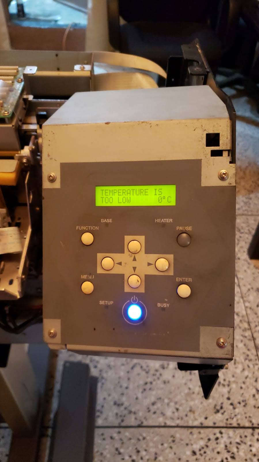

VP 540 Temperature is too low 0°C
Keevan

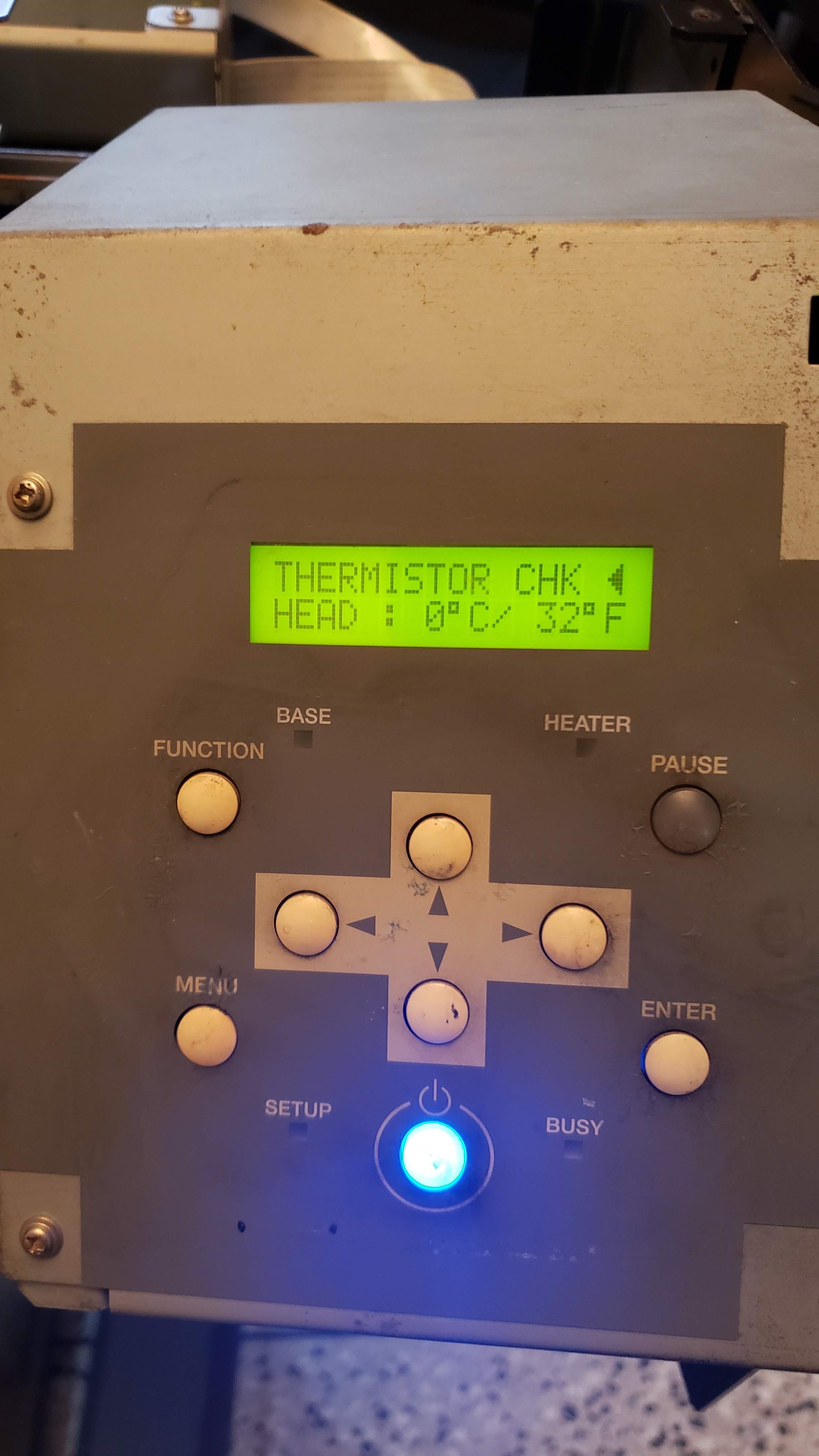

When power the VP on we get this error.
Second pic is from the service menu.

Keevan
Resolved this issue. The thermistor in the dryer was changed. Also plugged in one of the old printheads and it got a temp reading from the head at least.
