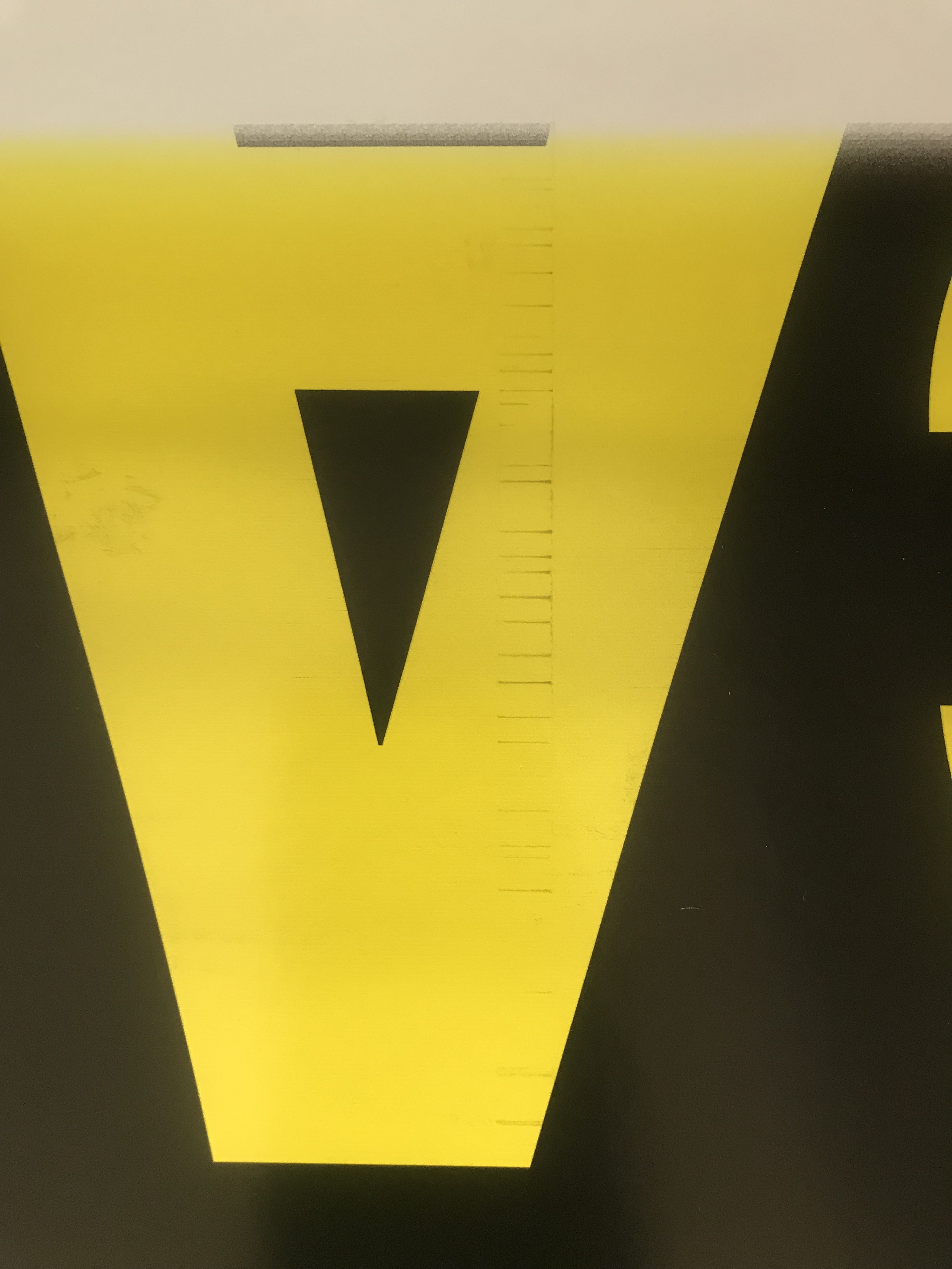

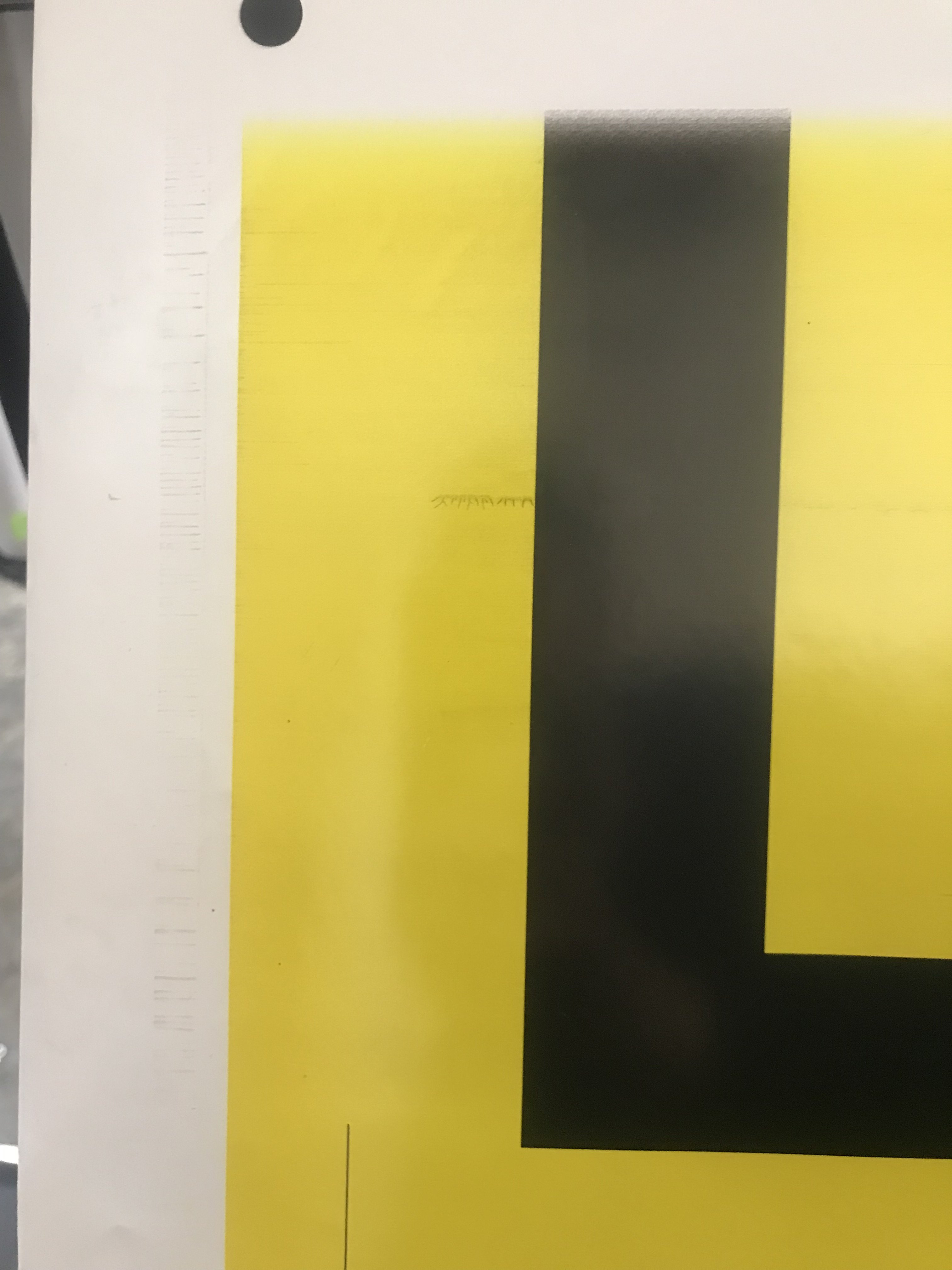

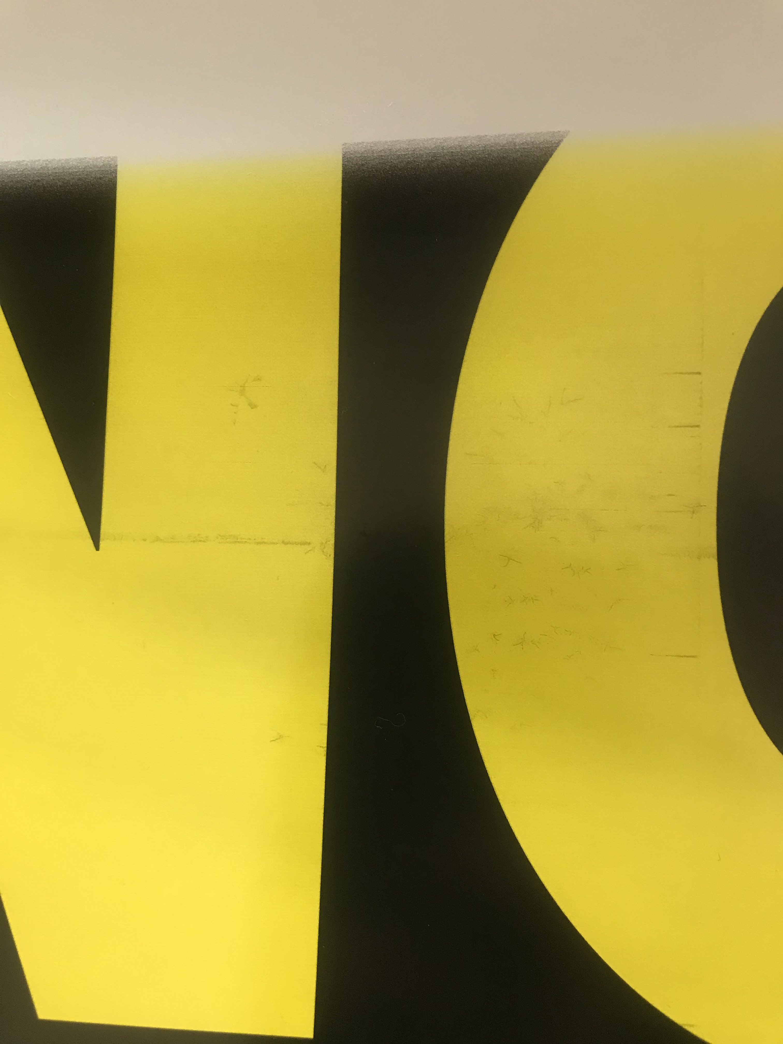

I am stumped with this one, its pretty wired, seams to happen were the wheels are and worse on 3M 40C usually when i print 100% black, can hardly tell looks like the yellow is doing it also
I am using Marabu inks that i got from my Roland dealer, not sure its the ink, a few of my buddy's use the same ink in there Roland and seams like they are not getting that problem,
Anyone have any ideas ??
Thanks

That is what i am thinking but the Roland dealer i got the ink from says no,
I pretty much totally restored the machine, new heads, cap tops, wipers, dampers, all new lines etc..
and it seams worse with the 3M 40C then anything else i use, I managed to get my jobs don't to a acceptable level
The Yellow i left at 100% and the black i used RGB black instead of solid 100%, and i removed all the wheels but the outside ones
people told me your wheels are dirty etc... they are brand new wheels, and the marks happen while its printing
the wheels do not go over the print after,
I am guessing maybe conditions might be part of that,
What would be optimal conditions for this printer to run perfect ???

It weird, i noticed if i change my black in versaworks to C0% M0% y0% K100% it is really bad, but if i use simple RGB black i still get a bit of misting around the edges but makes most jobs acceptable
but i do have to remove all the wheels,
I have a few things i will try and i will keep you posted.

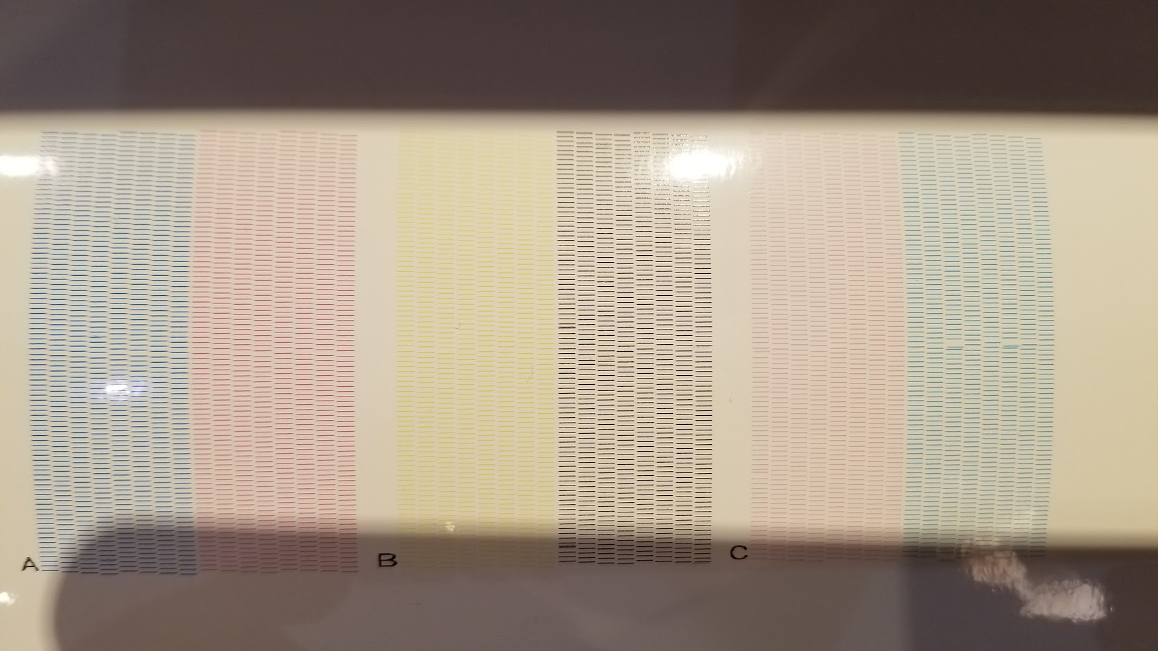

Try head height to high. Print unidirectional. also can I see a nozzle check?
anthonyd969
Hello, Here is the test pattern.
Also,
I got the humidity up in the room with a 2nd humidifier to 35%
AND I removed the center media wheels from printing.
Seems to work now....

That's pretty classic static electricity problem. You develop a charge as the vinyl peels off the roll and then you get another charge as the vinyl rolls under the pinch wheels. This can either attract or repel ink from where it's being directed from the jets. Also, different medias generate static at different rates.
Higher humidity will help dissipate the static charge so getting within the manufacturer's recommended environment is helpful. Also, printing in a slower print mode - higher number of passes or using unidirectional printing instead of bidirectional printing or slowing down the carriage speed all help reduce the rate that static will accumulate on the media - this may get you through a period of very low humidity in a pinch, but the best advice is to bring your print environment within spec. At the very least, this will help reduce the number of variables that we have to consider when troubleshooting print problems.
