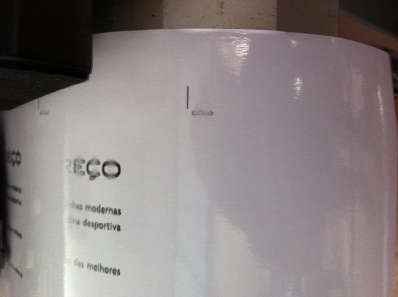

I´m having a strange problem with my Vp540. The black is doing some heavy horizontal spray. Vertical prints perfect. The nozzle test prints perfect too and i did all the service menu print head calibrations. Any ideias of what can cause this?
Here is a picture of the problem. Hope you can see what i´m talking about
What you see in the picture is a crop mark, and you can see also in the text above the crop mark
EDIT: it doesn´t happen in High Speed mode. Only in Standard and High Quality :S
Thanks in advance for any help!

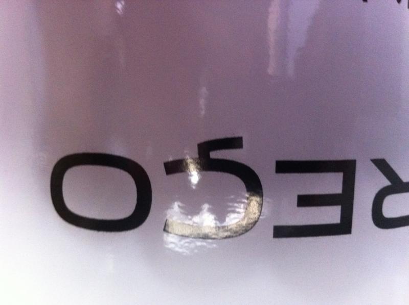

it also happens in High Speed, but is less noticeable. If prints thousands of ink dots arround the text.
Hope you can see it in the picture, arround the Ç for example

It's called "deflection" and it usually starts right before the print head goes. Have you had any head srikes lately? If you run a print test it will show you how bad it is for sure. You may also want to try a deep clean and see if that frees it up at all.
Also, to cheat a little with the black text, change the color formula in your CMYK file to C=40 M=30 Y=30 K=100 or in Versaworks use the "MAX IMPACT" setting that might also work.

How the nozzle check? Do you have any misfireing nozzles? That might be the cause. If the test print is fine, then the print head must be replaced. It's very possible to be a static issue but I don't think so. Check the print-head surface for any dry ink spots.

The nozzle check is perfect! And the print head is recent! I checked the encoder strip and it´s clean.
If it was a static issue, would not the other colors print with deflections too? And how about the spray beeing different in different print modes?

What is your head height set to? I have seen this when the head was set on high.
wochi
i tried with different materials. Vinyl, Banners, flex. It does it in all of them. I tried different temperatures also but i usually don´t mess with them so it´s strange to start doing this only now...
