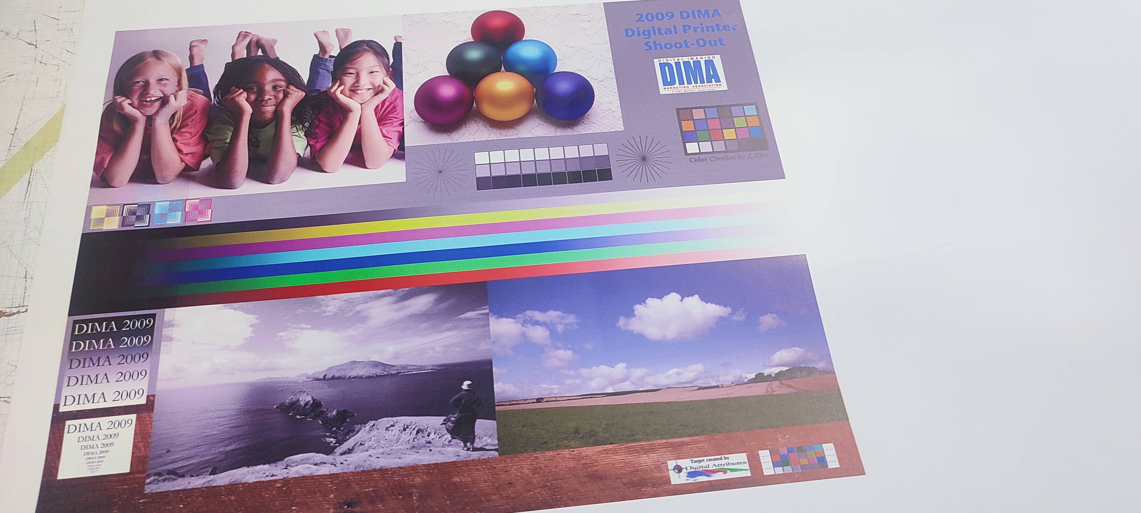

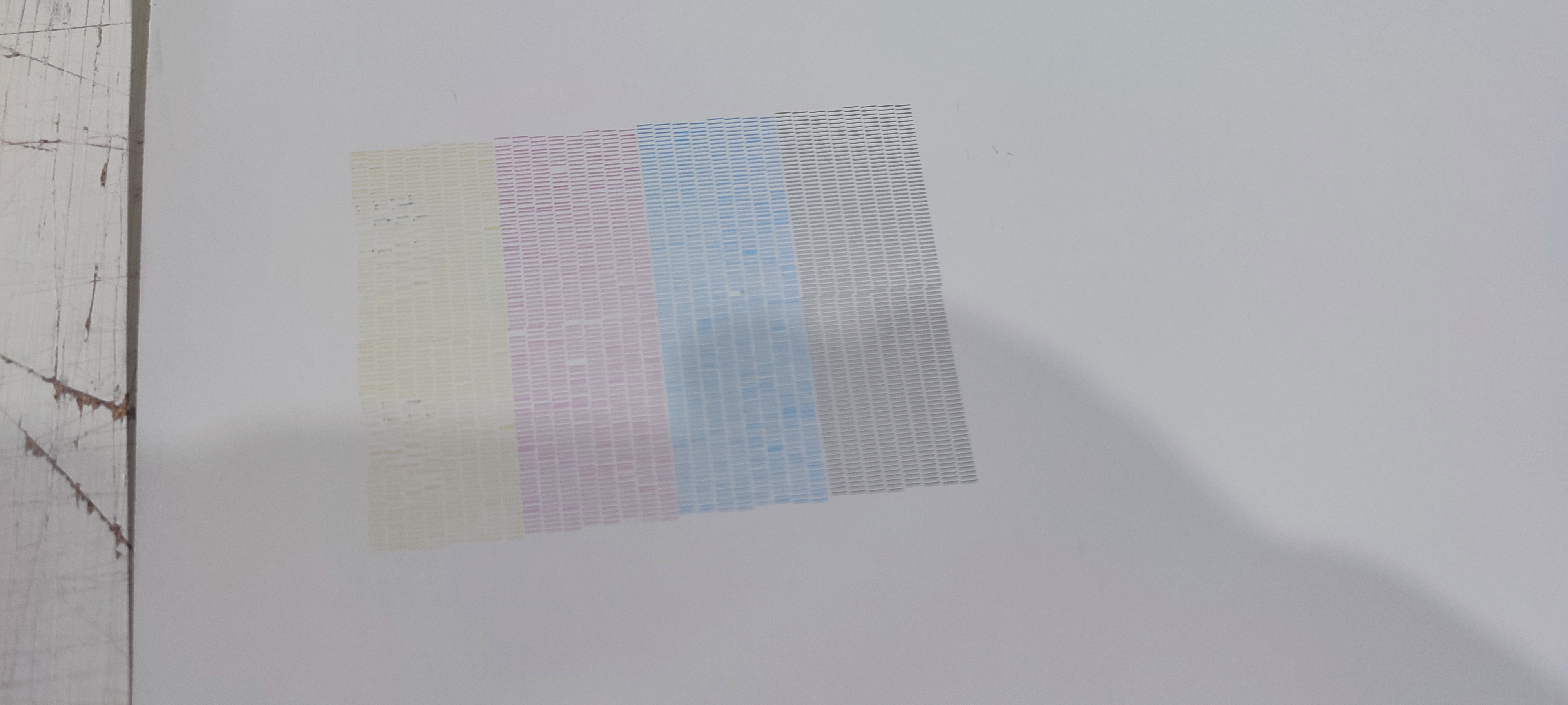

I have a problem with the color tonality. The nozzle check seems ok, bit I am getting all prints more magenta than normal. This has happend suddenly ... no changes have been made.
Anybody has had this?

You have lots of deflection in that nozzle test, however that wouldn't be why it would change, my guess is the cartridge, have you recently changed the Magenta cartridge, it wouldn't happen right away after changing, as it takes a little for the ink from the cartridge to reach the head once changed due to the remaining ink in the lines from the previous cartridge. Could be due to an expired cartridge or just needs a good light shake.

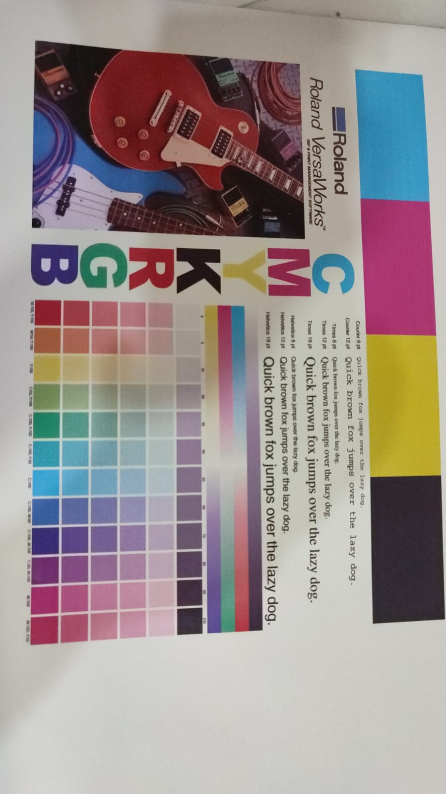

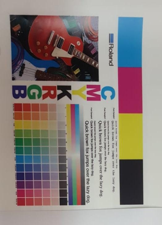

It seems the issue is with the greys. here are a comparison from another machine.

Looks like it's putting too much Magenta down. I have this issue with my VS-300i and to correct it, I just take out some Magenta in the color adjustment in Versaworks, has worked so far, and I've been doing it since I got the machine.
