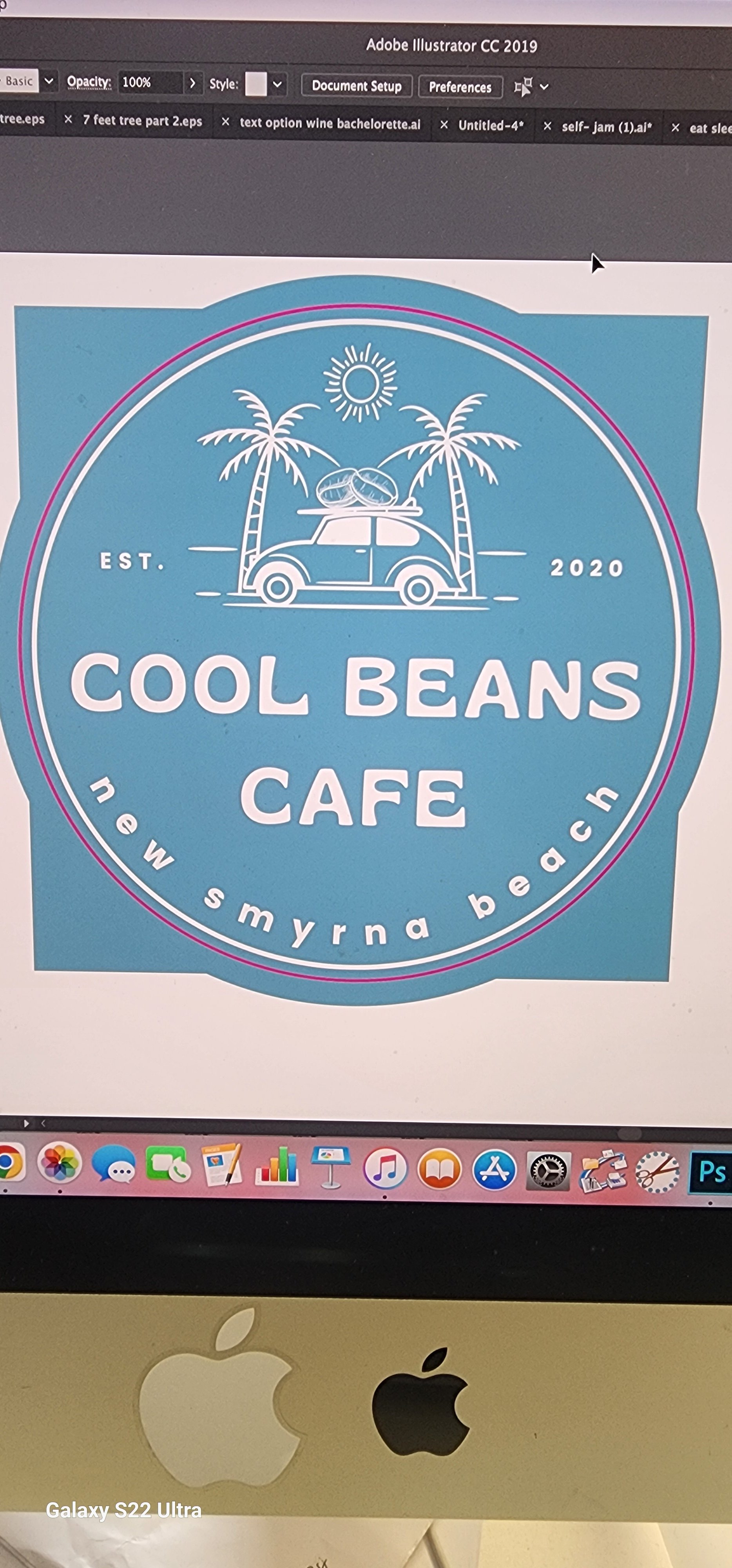

I'm needed to print and cut some stickers. For some reason cut line is way off from where I want it to be.
I watched some videos , and calibrated "cut with crop marks" via printer menu. But it didn't make any difference. I pretty much only print wall decals. I don't have any issue with regular cutting or I never noticed. I haven't done any stickers, and cutting with cropmarks in months. I think I set up vinyl right way and VW media settings I have checked " center on the media ". I did cut them in batches of 100 stickers. So I dont think vinyl moved. Every single batch came out like this.
Last time I did stickers, I didn't have this issue.
Any idea why is it happening, and how can I fix it.
