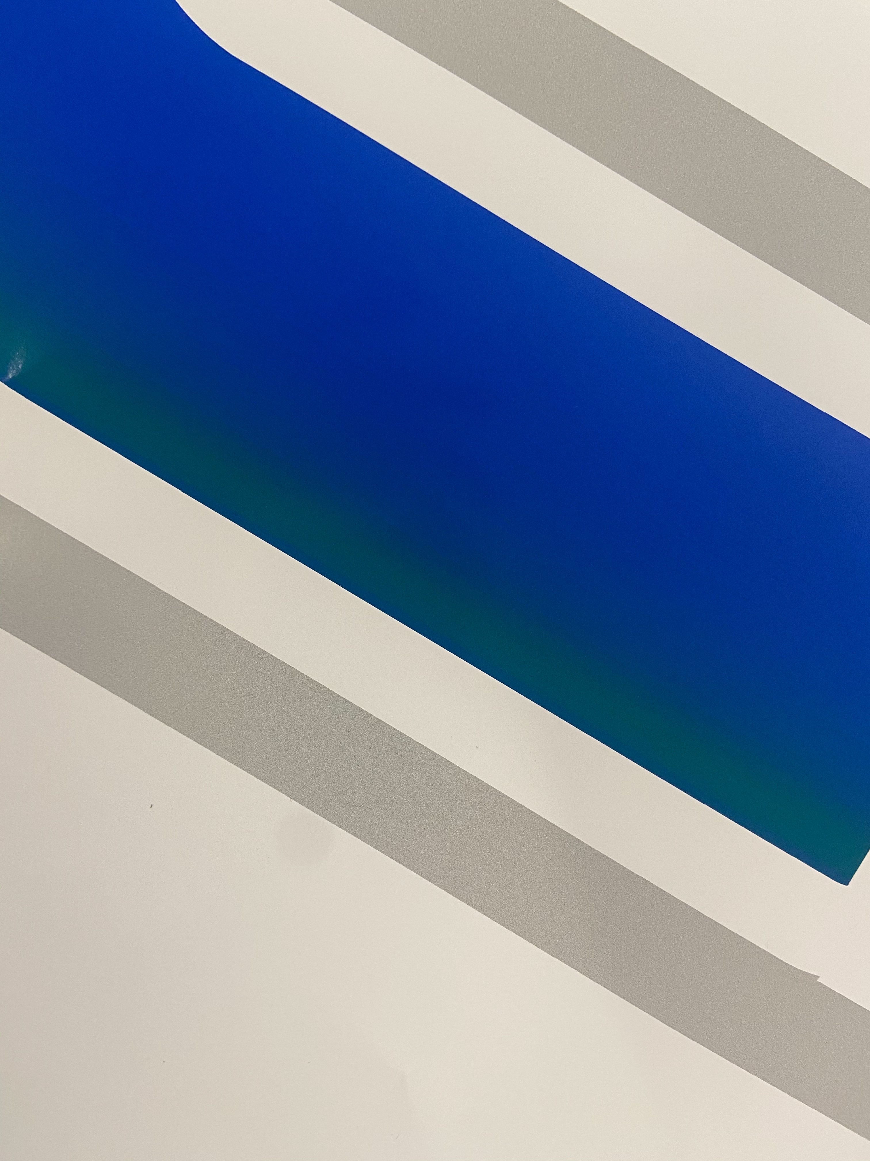

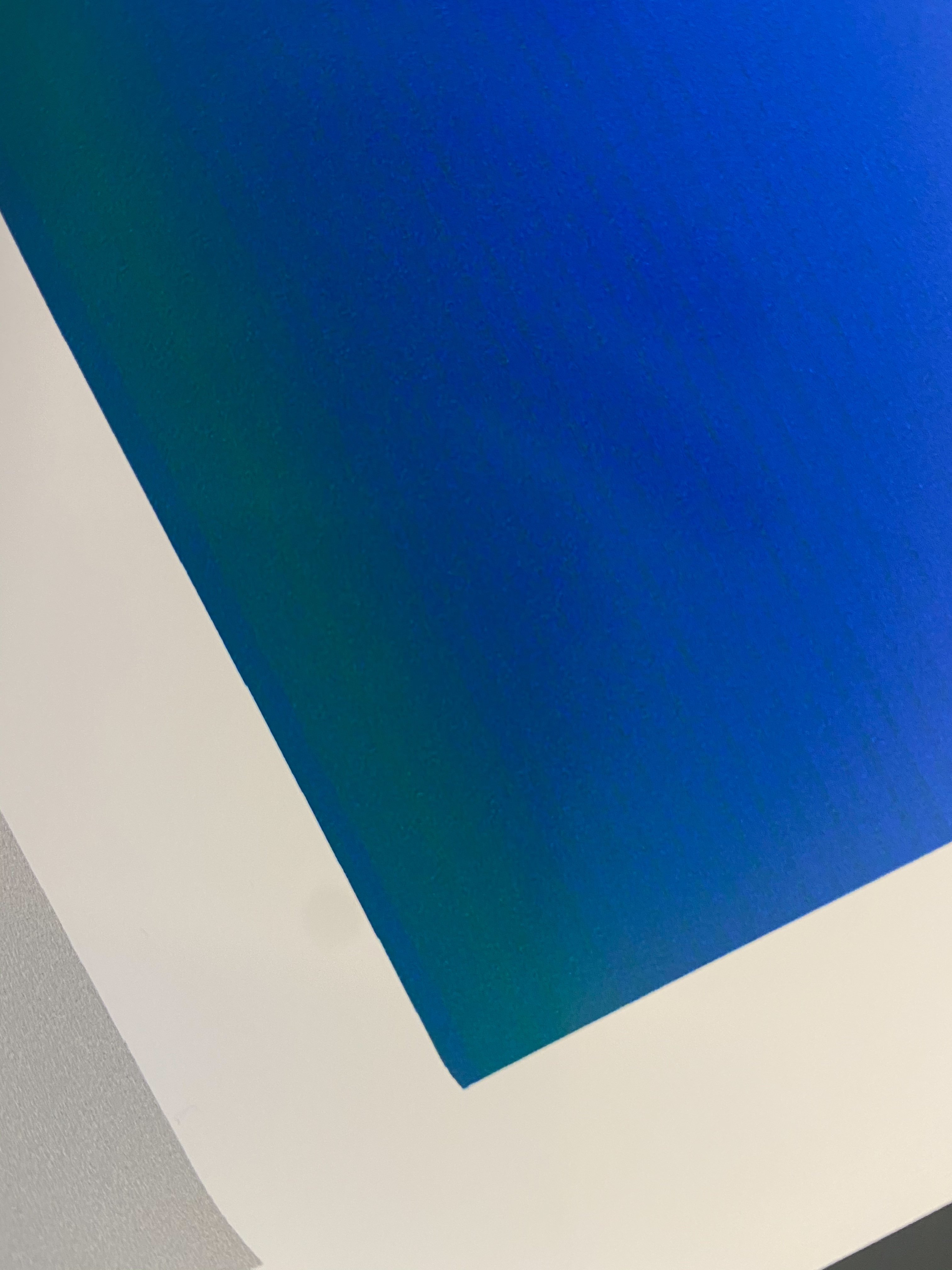

Hello, A few times when I start printing Blue in graphics I Noticed the blue starts of Printing as green, then goes to Blue , only happened a few times but worried it will get worse as time goes bye.
Any Help or Suggestion on how to fix would be appreciated
Thank You

It's probably cross contamination. Check your nozzle test to see if the cyan has some yellow getting into it. At the end of the day it's usually a weak damper, bad cap top, or partially clogged pump/waste tubes.
