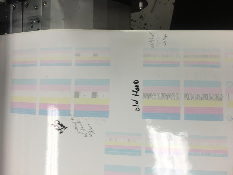

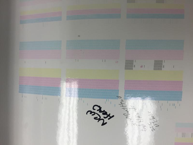

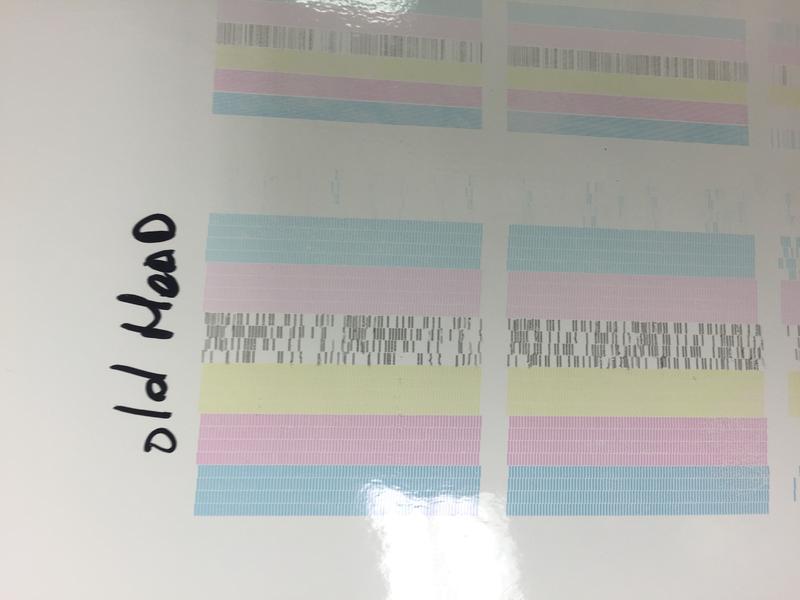

Well, after over a week of being down, I needed this fixed. I called a Tech to come out, a certified Roland service center and dealer. . Right away the tech believes the head is bad. He initially changes the damper with a new one and runs choke cleaning along with other cleanings. All of this on my original heads, no changes happens. I give him the ok to change the head since he believed this was a head issue. The head is now changed, the service will cost approx 3000-3100$ to have done. He runs a choke clean along with other cleaning the nozzle check look worse than with my original head. He takes another look at dampers the boot is once again coming off of the damper on the new head. Damper # 3 is now installed. more cleaning, more ink wasted, more money lost, no changes and still looks like crap. A call to Roland is made, this was very brief. The Roland tech support stated he wanted to flush the head from the cap lines, and a flush alignment done. Both are completed, no changes, we are actually getting progressively worse nozzle checks. The tech tries Print Head #2, we are now getting approx 2-4% black ink nozzle checks with Print Head #2. At the end of the 4 hour span I would say 6-8 choke cleanings were done and approximately 20-25 normal to powerful cleaning performed, only for the tech to leave with the nozzle checks worst than this morning, and a broken printer. They are scheduling another trip out for Wednesday. Oh yeah the 3100$ was for the head only and trip charge plus 2 hours. We are now 4 hours in, 2 dampers(same ones), a Print Head, ..... This will be getting interesting, considering my print head was probably never the issue to begin with.
Extremely disappointed by the lack of support from Roland to the field techs!!!

I think that it's going to turn out to be an electrical problem like cabling, or driver board. Looks to me like the black is just not being fired properly. I hope you get satisfaction though.

I was also thinking of an electrical problem may it be the head cable, head board or even fuse. But don't know how the VS boards are configured / built.
Have you tried swapping the Black head cable with another colour just to see if the K channel fires up? If you happen to try this out, I cannot stress enough to ensure that the entire printer is turned off and power cable is disconnected. Wont hurt to hit the power button a few times once the power cable is disconnected too. (Pretty sure you already know this though)

Could possibly be an electrical problem you could try changing the print head cable cards 4 of them they are inexpensive also the 3 cable cards from main board to head carriage board again inexpensive to buy and not too difficult to change this would rule them out if nothing else, then if you still have the problem change the head carriage board, take a look at these www.digiprintsupplies.com there in Belguim but ship everywhere you'll probably get them next day, do you have service
manual??
