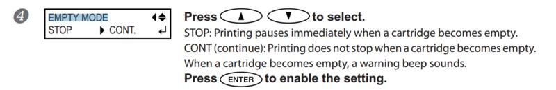

Also this might help both of you.
Menu->Sub menu->ink control->empty mode

I checked the ink control menu as you suggested, but it was already set to "stop". I guess it's probably a board issue then?
